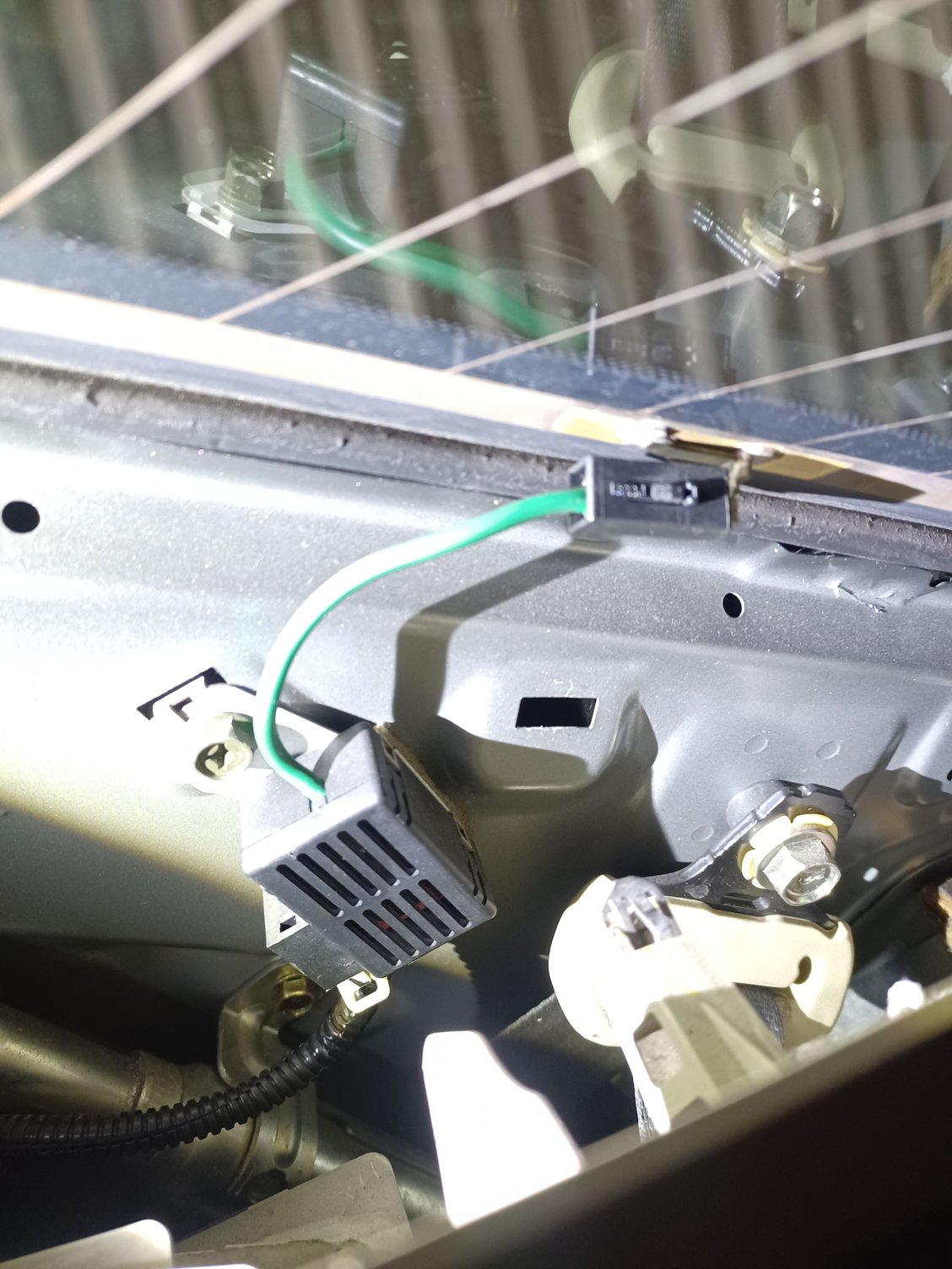

(07 coupe MT) so im looking to diagnose and fix my rear defogger and im having trouble looking for what i need to find. My haynes manual doesnt come with a wiring diagram and i havent been able to find anything online. The dash light does come on, ive checked all the fuses under the dash, behind the battery and have heard the click of the rear relay, tested a new relay and nothing. Ive also tested the wiring at the window and get nothing on my tester. Ive pulled back the plastic trim to expose the wiring along the glass to maybe see something, but without a diag im not sure what to look for. Some advice or a diagram would be radical
These connector run from the left of the dash strait back
The wiring along the left side of the glass
The bs on the right, this is the only connector i saw
