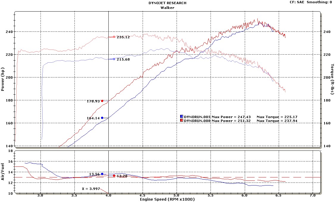

You should dyno in 5th it is the 1 for 1 gear. My 05 Z baseline runs were 245 on the dynojet and every one else at that dyno day was in the 240's. Most shops dyno in 4th but that is because the old guys only had 5 speed cars not that we have 6 speeds our shoud be done in 5th gear. Here is my before and after headers dyno.
first
aem cai
5/16 spacer
mild port and polish
nismo exhaust
after
aem cai
5/16 spacer
headers
nismo exhaust
