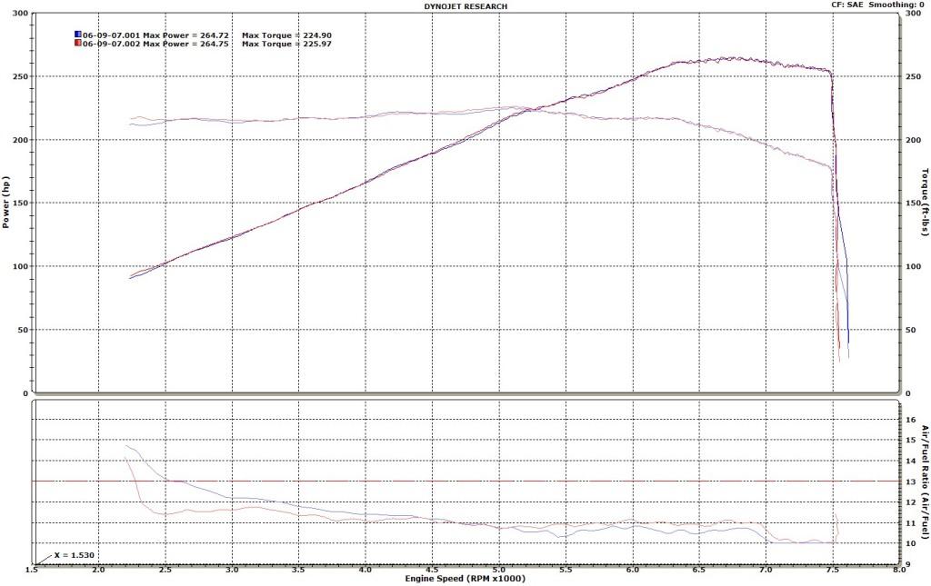

Cheryl dyno'd her car first. Her car is an 07 6MT Sedan, bone stock. It got some attention. A bunch of people were asking what we thought it would put down, and my guess was 265, based on other dynojet plots I've seen around the web.
This was the first HR for this dyno, and consequently, the first time the guys had had to strap down one of the new sedans. Fortunately it wasn't a problem, unlike when I had my 05 dyno'd at Z1 back in March.
I had the guy do the first two pulls in 4th gear, and the 3rd pull in 5th gear. For the 07 guys wondering why, the first gen sedans had a speed limiter of ~145mph, which meant that a pull in 5th gear would not go to redline.
The first pull netted 264.72/224.90. The second pull was almost exactly the same: 264.75/225.97. We're talking a difference of 3 tenths of 1 horsepower at peak. When the two plots are overlaid, they are nearly identical. Those are the two most consistent pulls I have ever witnessed.
The last pull, in 5th gear, yielded 267.21/232.67. So right around what I was expecting. After that pull, the owner was kind enough to entertain us with a few extra pulls for observation purposes. The next pull was again performed in 4th gear, just so we could see how far off the tach was. In my car, the tach is off by about 100rpms at redline in first, 200 in 2nd, almost 350 in 4rd, and almost 400rpms off at the top of 4th. We didn't measure the variance in any of the other gears, but it appears that the tach is still optimistic, right at 400rpms again. The tach registered between 7900 and 8k rpms before he encountered the fuel cut, and the measured roller speed of the dyno was almost an exact 7500.
After that, we tried to find the speed limiter. Unlike my car, it turns out that Cheryl's 07 can take 5th all the way to fuel cut. Then we tried 6th, and it topped out at a speedo-indicated 160mph, which was right at 155mph on the rollers.
One thing I noticed was how rich Cheryl's ecu is running. When my car was stock and dyno'd in the heat, my car ran rich, but nowhere close to this. At the beginning of the run, the a/fs were just under 12:1. They quickly leaned marginally, to just above 12:1. But they started declining at about 3300rpms, richening to 11.5:1 at 4500rpms. After that, they were stable until 7k, when the ecu just dumped gobs of fuel, enough that the a/fs were under 10:1 and eventually reached a flat 10:1 at redline.
I have no idea what the future holds in regards to tuning, but there is a lot of power left on the table based on a/fs alone. The a/f's are so rich that for a novice like myself it appears the car is ready for boost from the factory.
I have attached two images to this post. The first post includes the plots of Cheryl's first two runs. Notice how consistent the new motor is. The second image plots her best run. Look closely at the a/f's.

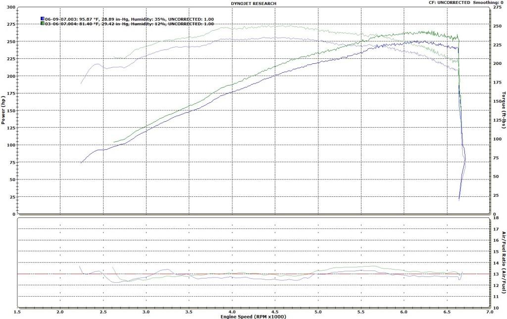

Now on to my car. When we arrived, one of my friends(owns one of the local shops) was there, and he asked me what I thought I would run. He remembered that my best was somewhere around 265, and I confirmed that he was correct. He told me not to expect those numbers that day due to the heat. He said several cars were down on power. I just smiled, and said "we'll see." From then on, he kept poking fun at me saying I wasn't going to do better than 245.
So after Cheryl's car was done, I pulled up my car and they strapped it down. I did my typical procedure of 4th, 4th, and 5th. The first pull got me 259. The second 261. Then the third gave me 266.40/248.87. So much for 245
What can I say, I know my car. My a/fs weren't as steady as when it was tuned back in March, but much more steady than stock. I've removed my stillen airbox, but it hasn't seemed to have affected my tune very much at all.
The conditions were awful. Temps in the garage were between 95 and 98 degrees for all of the runs(for both Cheryl and myself), and the pressure was dropping. The baro was only 28.81. So the correction factor was an incredible 1.06.

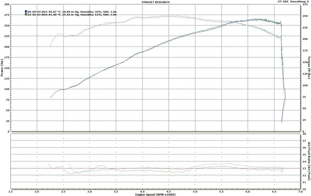

That proves one thing about correction factors on dynojets. Compared to my last dyno in March where the correction factor was 1.00, the plots were almost identical.
So let's compare the power of the two cars: at peak, my car made .8hp less than Cheryl's car. At peak, my car made 16ft/lbs more torque to the wheels than Cheryl's car. But that only tells part of the story. When the two plots are overlaid, one can see where the differences lie.
From 2500 to 2750rpms, my car is a dog, making between 10 and 12tq less to the wheels. From that point there is a surge(you can feel it when you drive), and the two plots cross at 2900. At 3500, may car benefits from a 12tq lead; at 4k, it's 30 ft/lbs. From there my car's advantage slowly declines. At 5k rpms, it's back down to 13 ft/lbs. At 5600rpms, it's 15 ft/lbs.
The major difference in the two cars lies in the power delivery after 5500rpms. At 5500, my car is making 96.9% of peak horsepower. Cheryl's car, on the other hand, is only making 89.5%. From 5500 to 6300, my car only picks up about 10hp. Cheryl's car picks up twice that, eventually peaking at 267 at 6900 rpms.
I have attached 4 images. The first is my best pull of the day. The second is an overlay of Cheryl's best pull versus my best pull. The third shows how my best run back in march, with a correction factor of 1.00 plots versus my best pull from Saturday, with a correction factor of 1.06. The last image shows the same two runs, except this time they are uncorrected. I find it interesting that the heat, humidity, and low pressure cost me 12 to 15 ft/lbs of torque over the entire range, in raw uncorrected hp.
