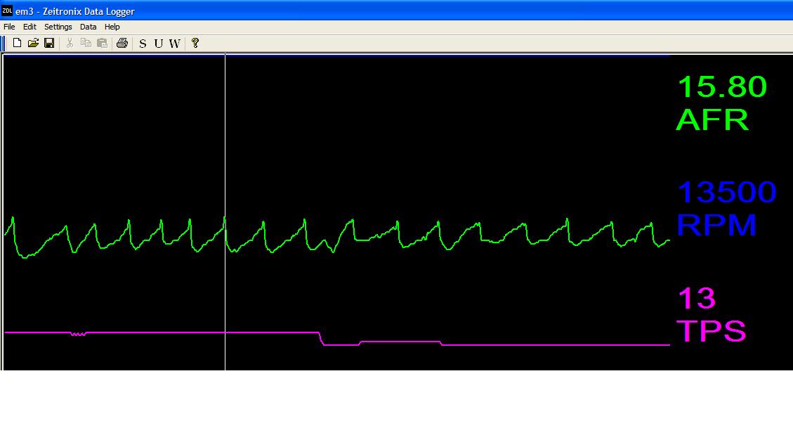

Actually, your AFRs are pretty normal. The stock ECU tunes your car for 14.7 AFR. It looks like you're right around 15, which, considering the tolerance and the amount of use the WBO2 sensor you used, should be just fine. You could drive like that all day long until your car falls apart and not have to worry.
Here's one of my many datalogs. Ignore the RPMs. This is what your AFR looks like when under about 6k rpms, even if you're near WOT, and especially if your ECU has adapted to Highway driving. The peaks are about 15.8 AFR, the troughs are 14.2 AFR. This particular datalog was done with MD 5/16 spacer, K&N drop-in filter, headers, & HFCs with Emanage to about 8 months ago and was taken using my Zeitronix WBO2.

In regards to NA: Many, actually all tuners that I have spoken with, they confirm that 13 all throughout the RPM is the ideal AFR for power.
Ofcourse, it's usually a bit out of wach from as low as 1500-2500, but it can still be set to 13.
I remember seeing Punkidd e-tuning someone's osiris: it ranged from 13.2-13.0 through out the whole powerband
