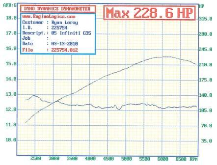

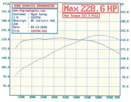

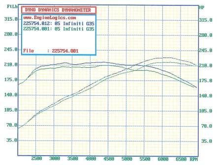

I went up to get my car dynoed and tuned on Saturday and was a little dissappointed in the outcome of my numbers. It was done in Houston on a Dyno Dynamics machine. My mods are listed below. Oh, and I didn't turn my VDC off during the tune and maybe thats why the numbers seem a little lower, but I didn't that that would matter that much. Let me know what you guys think.

So gains were about 10hp/10tq? Hard to tell exactly from the graph only.

Ya it was a gain of 11 HP and 10TQ

Anyone with a helpful comment for the OP? What numbers should he have reasonably expected? I've seen claims of 20-30 with a tune and not-too-dissimilar mods.
