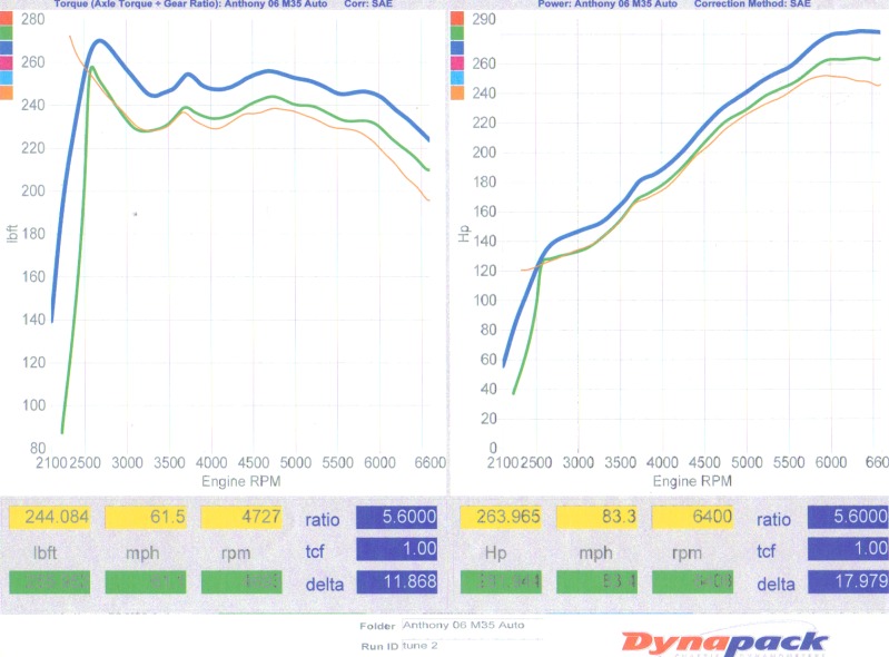

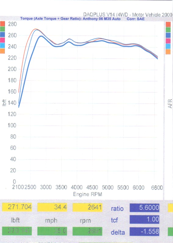

Originally Posted by Footballmania32
Those are some fantastic gains. Do you have any dyno sheets? I'm most impressed by your final torque numbers.. 262 @ 3800rpm. Damn, the fun starts early!!
hey Footballmania...I posted one of my dyno sheets on another thread you commented on
I can't locate the sheet which displays the run I did with the BERKs installed...it's actually very frustrating since I know I put in the same place as the others
anyways, here is the pull prior to the Berks added(same as other post to different thread), as well as a pull done to see my TQ - enjoy...
TQ sheet:
