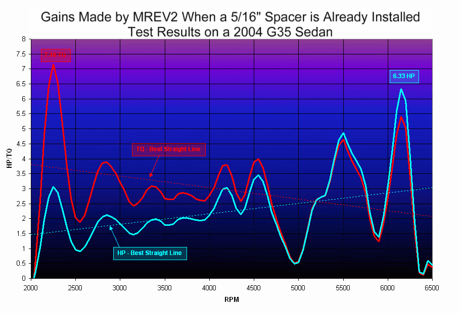

There have been proven gains using both the MREV2 and the 5/16 spacer on the nonrev motor. On a cost basis, its not worth it for most, but I got a good deal on this MREV2 and I couldn't pass it up.
If you give me a sec I will find a dyno chart reflecting gains on a nonrev sedan.
As you can see, it does help in the low end of the spectrum. These gains are before a tune, which should correct the 4500-5500 rpm range and provide further gains throughout.
