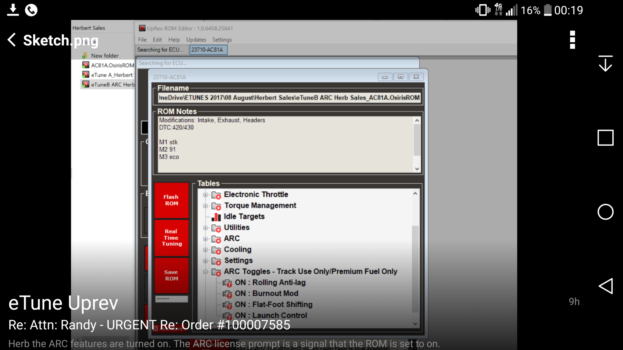

Dustin and Randy of uprev just replied, pointed out indicating my ARC is good to go. But what am I missing here concerning my toggle switch ain't responding to 2 step feature? Basically its just; VDC off, clutch in, and 1st gear. Then just floor it above 3k rpm witch should activate ARC? Correct? Image by uprev personel.
floor it from idle, don't slow rev it up to 3k, just instantly mash the gas. Also make sure car is warmed up, there's a minimum temp setting to keep you from hammering on a cold engine.

If all that is good, then another potential issue is throttle pedal voltage being a bit low on WOT. I think most of the ARC features need to see pedal voltage around 4V to activate. You can check this by going into logging, turn car on (but don't start), push the gas pedal all the way down and check the voltage. If WOT voltage is only 3.5V or something lower, then the ARC launch control won't ever activate.
Sorry if that's overly complicated, I troubleshoot electronics for a living, lol.

Thanks to Luis! I clutched in, down shifted from 6th gear, floored it above 3k, and it actually stutters upon pressing CANCEL button. Is this a solid confirmation concerning my ARC is in? Please advise.
I think you're the same guy commenting on one of my Instagram videos?
Yes, ARC features are confirmed on your car. It's all user error at this point then.
