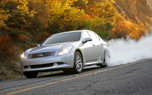

Really ? I actually read it was one of the best cars for burnouts, due to high HP, not too wide of tires. I'd have to look up where I heard that. Here is a photo from that article.
Possible to turn off VDC and Video on Screen-07_infiniti_g35_f34_burnout_500.jpg
Attachment 92591
The car in the picture is a RWD G35S
