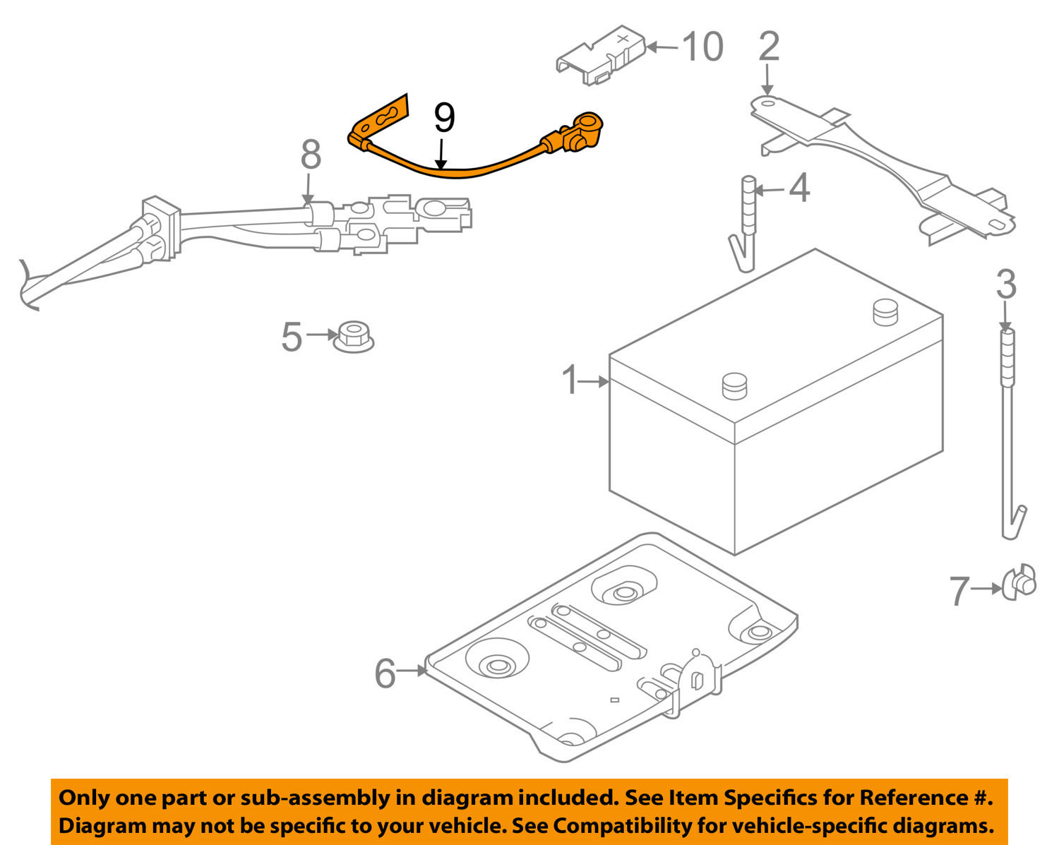

Yep definitely sounds like you have a bad battery cable. Completely remove the ground wire from the vehicle and I bet you find a nick in the insulation where it's rusted away the conductor inside. Junkyard would be the quick and easy way to get another OEM one but it's possible the issue is the positive wire also.
Are you talking about this wire #9 as per picture?
I do see rust on my current one.

Yes that is the ground wire, it's really short and just goes from the negative terminal to the chassis and bolts down with a 2-hole lug.
You can test it for resistance with a digital multimeter, should have ZERO or maybe ONE ohm of resistance. Chances are if there is significant corrosion or rust then it's a contributing factor in these problems you are having.
