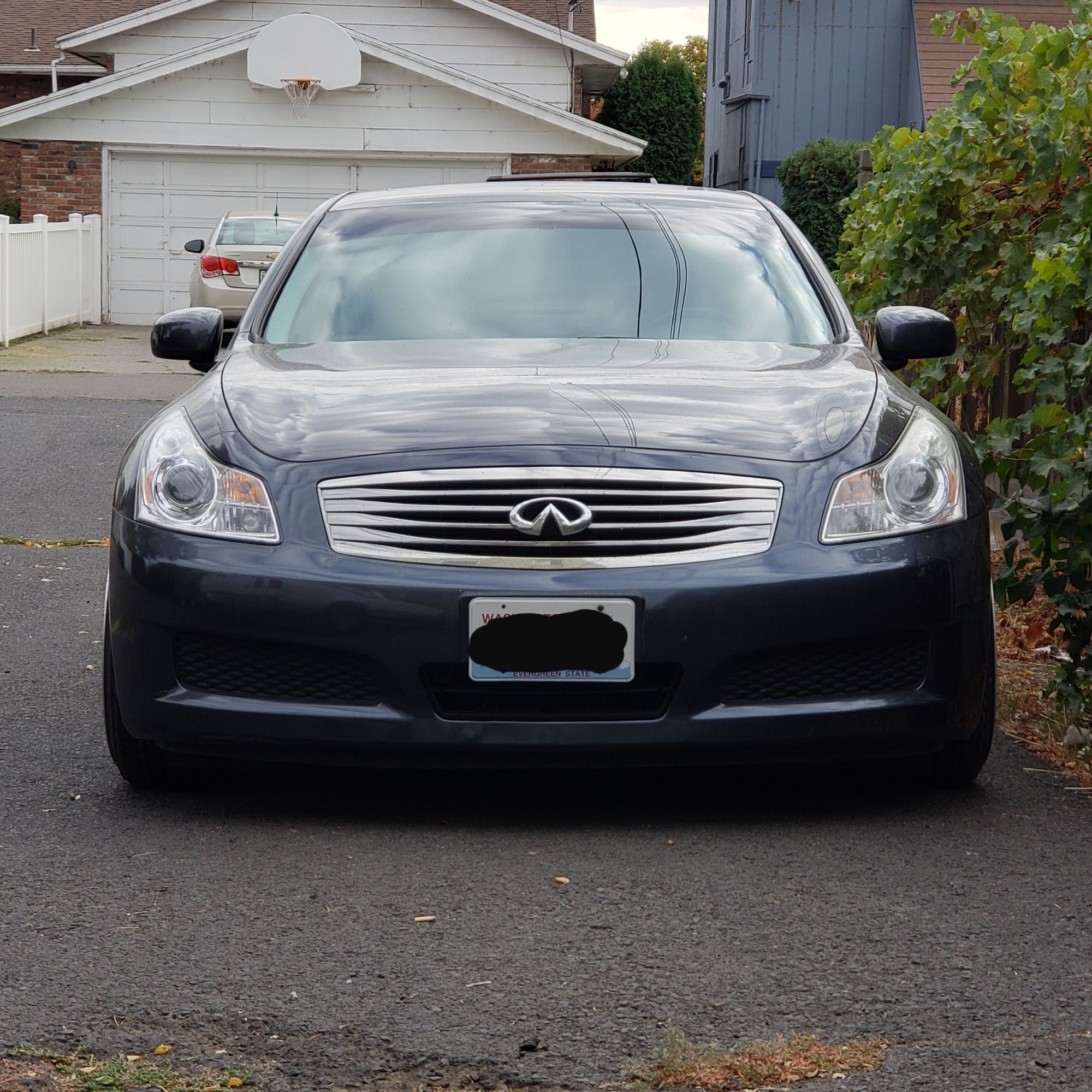

Just got done lowering G35X AWD and put on wheels...
2007 INFINITI G35X AWD
With Tein S-Tech lowering springs front and back
AODHAN ds02
19x9.5 Fronts
19x11 Rears
+22 offset all around
