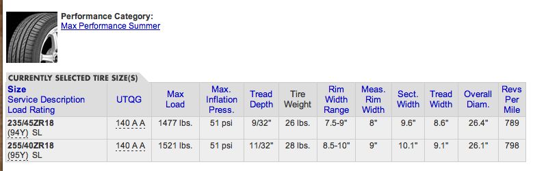

By using the mfg's recommendations, you can use the same size front and rear but it's probably not going to be as wide as you'd like.
you may be limited to a 235 front and 255 rear. all you have to do is find the tire or size your interested and look at the specs. There's a 'Rim Width Range' listed for every tire and this is the min. and max. width allowed for a tire.
Can you put a smidge wider tire on 7.5" wheel; you probably could but it's not recommended and can sometimes increase tire wear. Most people think those rim widths are for safety but really it's the mfg's recommended widths to obtain ideal wear on the tire, outside of that range, it's probably going to have too much roll on the sides of the tread or something.
So, using that logic, the mfg. says the 235 is as wide as you can put on the front rim, but you can probably get by with a 245, but it's at your own risk. Honestly, it probably won't affect a lot, it just won't be quite as square on the sides. one thing it will do is protect the wheel more.
Look at the attachment for an example.

Actually if you go to http://www.tirerack.com/ and punch in 245/45/18 size tire and go to the specs of most manufacturers, it will say the recommended rim width is 7.5" to 9"
