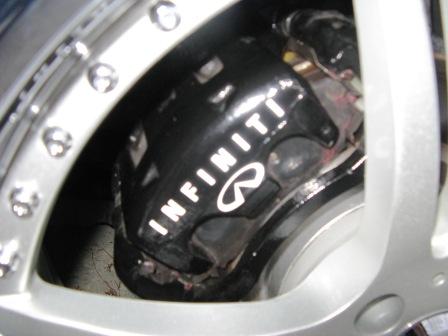

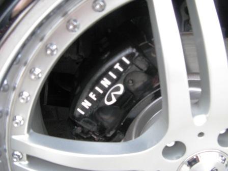

Here are a couple quick pics I snapped this morning
I used G2 caliper paint...It is rated to 900 degrees
The difference between the G2 and Duplicolor is that G2 is actually a 2 part epoxy instead of a paint....

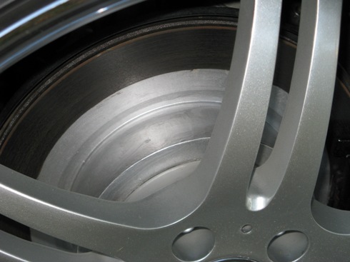

Yes I painted the back as well. They are small but being black doesnt make them stand out at all...really I just didnt want any of that ugly *** rust showing...I also painted the inner part of the rotors silver....
