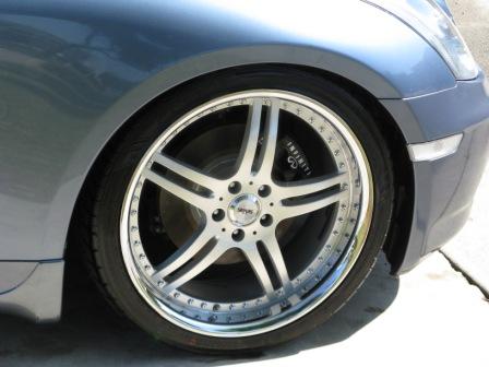

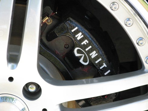

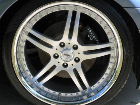

Really??
I painted my calipers as well as the inner part of my rotors about 15000 miles ago and have no flaking or fading issues whatsoever....I have also gotten warranty work done on my car at the dealer (not on the brakes) and they have said nothing about it whatsoever

Originally Posted by caltender
Really??
Attachment 103366
Attachment 103367
Attachment 103368
Mine look exactly like these but black on silver. Same on mine, slick, glossy, no peeling.
No will not void warrenty.

^^ caltender ur calipers look good...how they still holdin up? no fading or chip marks after 15000? did you paint the calipers while on the car or did you take'em off first?
Really??
Attachment 103366
Attachment 103367
Attachment 103368
Looks good good job

Looking great still,
Completely removed, cleaned and painted them.....You are supposed to let them dry for a long time (I think it was 24 hours) before driving with them
I have a meet tomorrow...I will get recent pictures ....I think those are from October of last year
