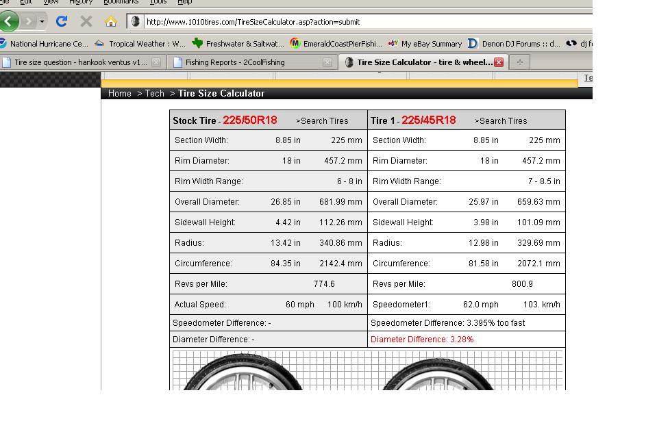

and how did you get those percentages? When I use the tire calculator you linked I get 2.67% for the 225/45 & that is well within the 3% threshold
real simple.
stock sport package 18" front tire is 225/50/18
newly proposed front tire size is 225/45/18
screenshot attached

weird, but if you compare 245/45 to 225/45 the difference is 2.67%
so in other words, a 225/45 paired with the stock rear size of 245/45 is perfectly acceptable. Really who cares what the difference is between the two different front sizes? its the front & back size combination that matters.

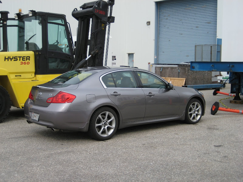

I still want these tires. I went back and looked at my snow tires, I run a 225/45F and 245/45R and I did not have problems with my VDC or ABS, so I guess that answers that question. However, the front tires did look a little weak, but I believe the offset of my snow rims makes it worse (rears are more aggressive and fronts are more tucked). I don't want my summer wheels to look like this though.
I might still go with the hankooks and run 225/45F and 255/40R. That gets the sidewalls as close together as OEM. The risk I'm worried about is a lower profile making the wheels look a little small (the 18" OEM's are barely cuttin' the mustard as it is).

I'm not feelin that 225/45 gap shown in your pix. Are you putting the Hankooks on the rims in your pic? If so, you might be able to do 245/45 all around.

I hear you on the gap, the offset makes it worse too. The new tires are for my OEM sport rims, those rims/snow tires are to get through the winter, they were bought from someone who sized them for a G35 coupe.
