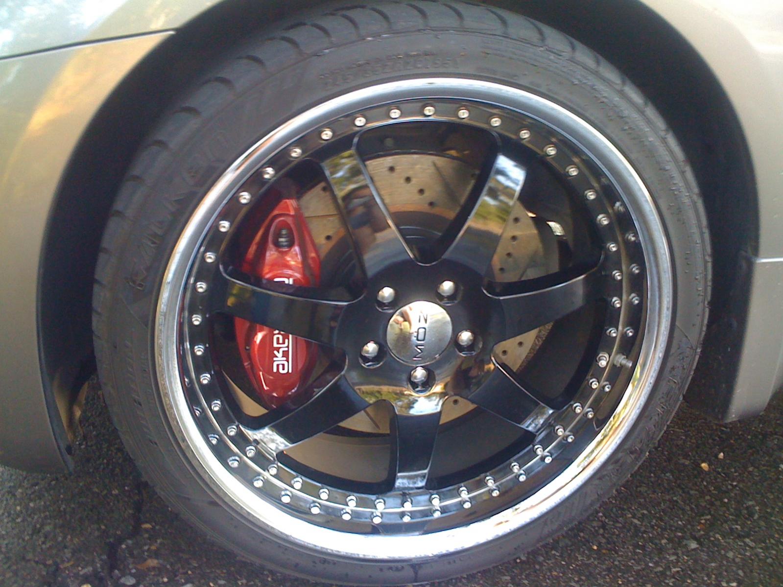

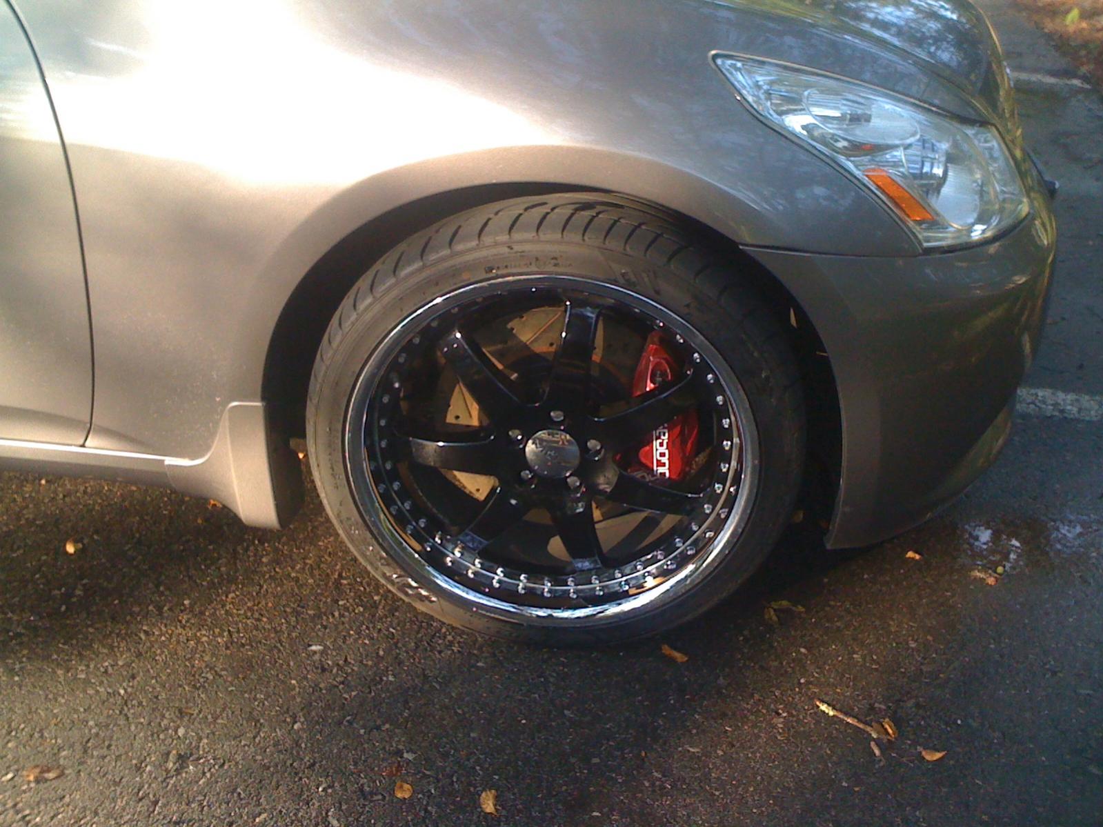

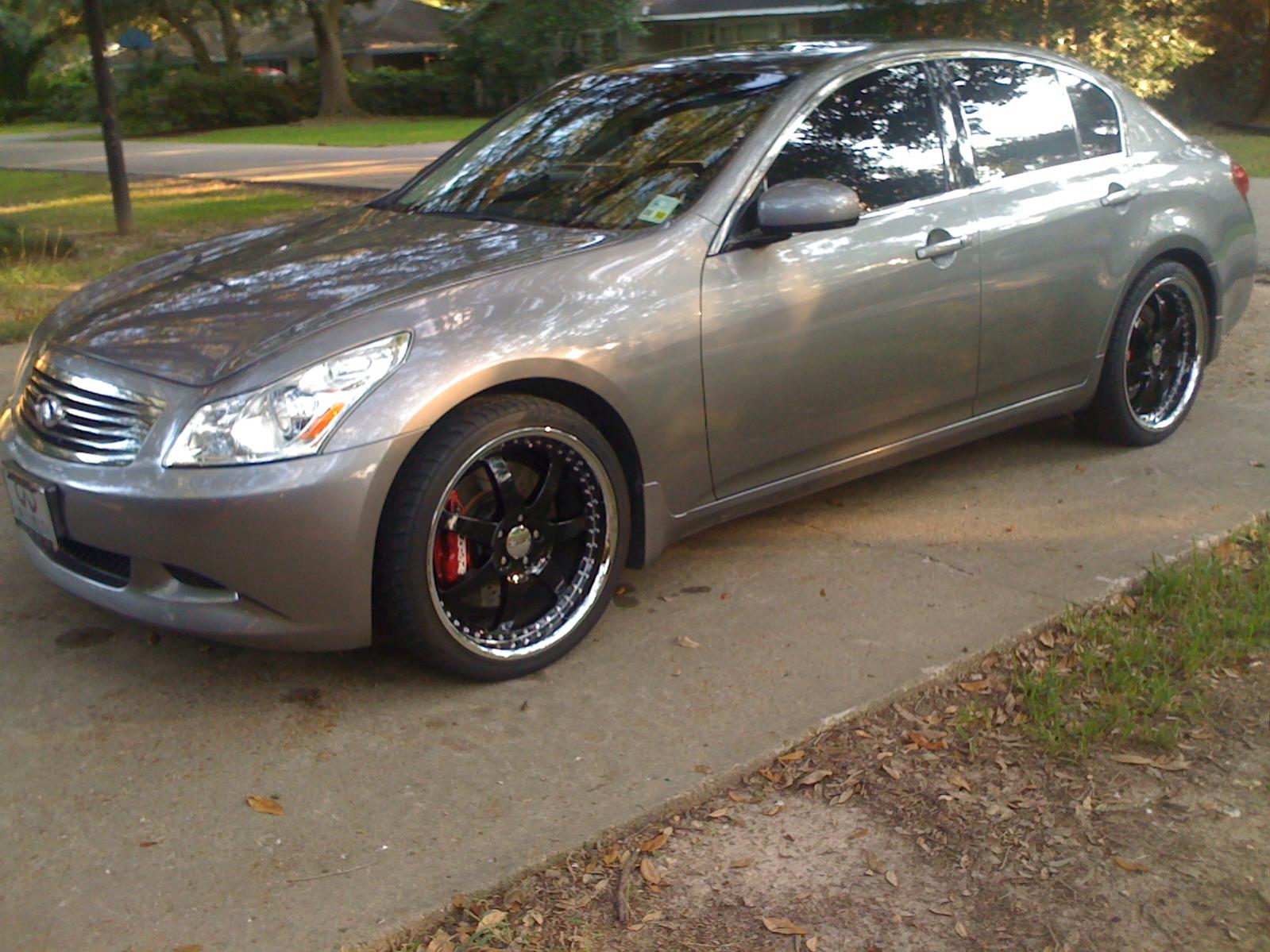

Hey Bob this was the only way I could send u pics of the M.O.Z wheels
Attached Thumbnails Question on Offset and Fitment-img_0166.jpg   Question on Offset and Fitment-img_0170.jpg   Question on Offset and Fitment-img_0182.jpg
