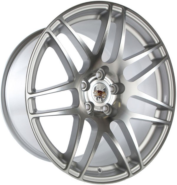

OK.....I've gone over the wheel database and am just more confused.
2007 G35 Sport Sedan, lowered on Eibach Pro Kit.
I'm about to order a set of Forgestar F14 wheels.
Looking at 19 x 8.5 front and 19 x 10 rear. 245/40 & 275/35 tires.
They offer custom offsets - F between +28 - +48, R between +20 - +44.
Not into the streched or poke look. Don't want 20's.
I just want them almost flush and not sunk in or stuck out.
What would be the perfect offsets?
Thanks in advance for any help !
Terry

Stock Sport Wheels are
F - 7.5 x 18 +45
R - 8.5 x 18 +50
Correct??
Old Aug 30, 2010 | 07:20 PM
Borna's Avatar
Joined: Dec 2007
Posts: 1,328
From: Dubai
19x8.5 +25 and 19x10 +40 should be pretty much perfect for what you're looking for.
