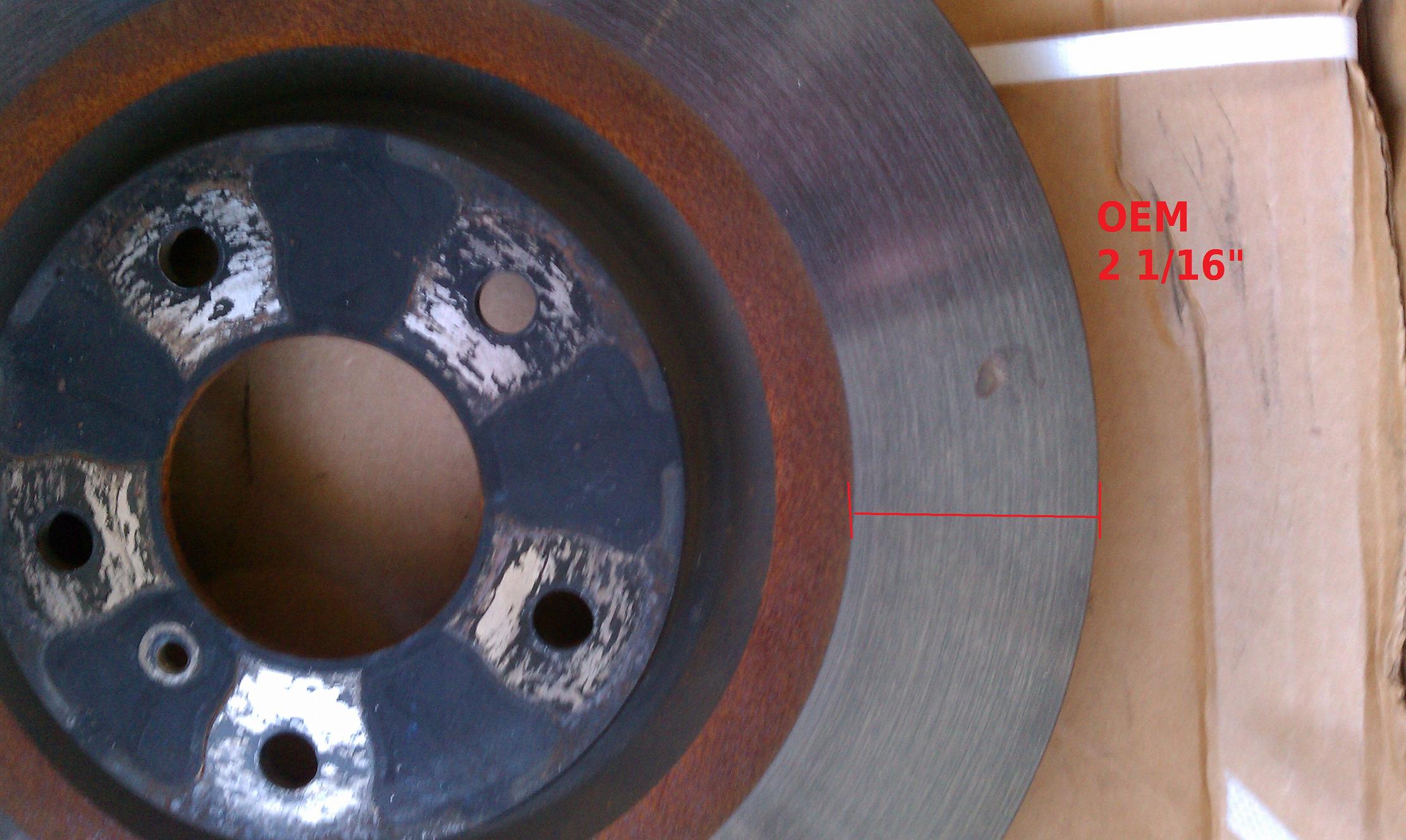

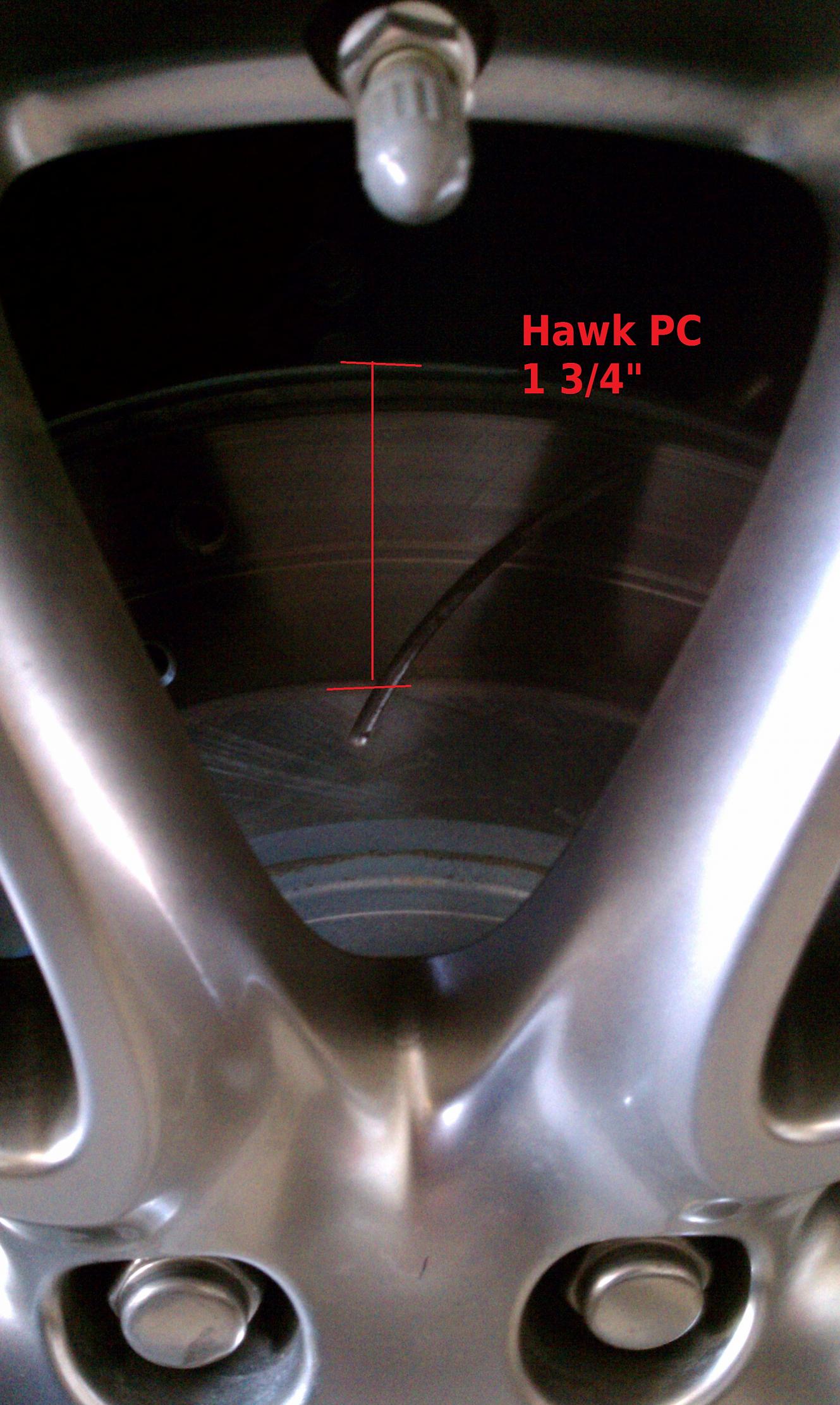

ok.. so here are the pics. The stock oem pads cover over one quarter inch of the rotor contact area than the hawks. So as far as I can tell hawk == performance fail, and oem == win. Just goes to show you (happens a lot like air filters) just because it's aftermarket and labeled 'performance' doesn't make it so. Also I noticed after reading the FSM that the oem pads are directional as well, the hawks appear to be unidirectional. Now I wonder if the hawk HPS and HPS+ pads also have the same weak rotor area covered at the PCs?

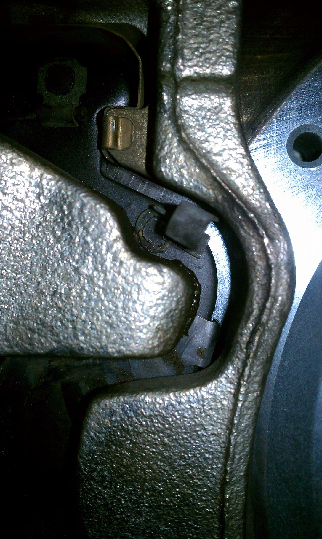

lol I think they are installed wrong. We got the shims on the wrong side I think. I took the wheel off, and noticed this (see pic) look closely and see if you can find what's wrong.
Attached Thumbnails Any 2nd gen 35S sedan owners have hawk cermamic (PC) pads?-imag0560.jpg
Old Jul 13, 2011 | 01:29 AM
rvanderwerf's Avatar
Joined: Apr 2011
Posts: 686
Likes: 44
From: Round Rock, TX
ok I switched my pads, now the ones with shims are facing upward on the inner pads. Everything looks ok now. So HAWK = win, installer = fail (me!). I just re-bedded the pads and everything is wearing in the rotor where it should. Next time I will read and re-read the FSM first!
