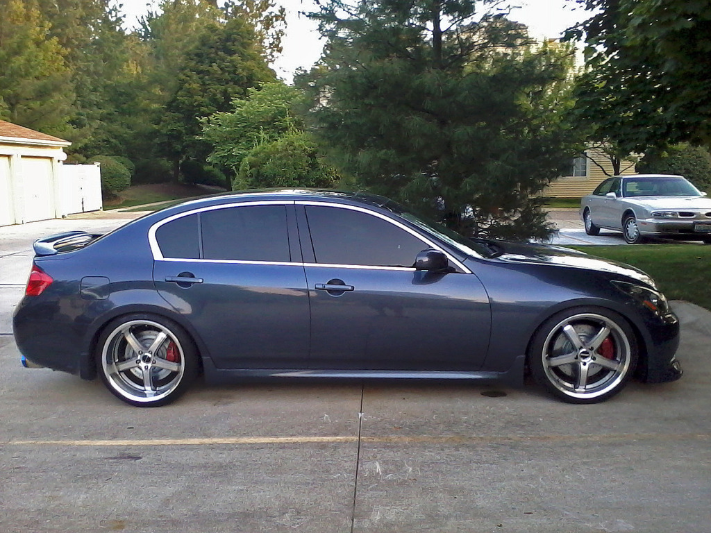

Yeahhh car is running and driving now. I'll post some pics soon hopefully. Fixed my front brake issue and about to go install my rear After Market wheels on see what I get.
here is just a quick crappy phone shot. Installed my rear wheels on. Everything looks good. Anyway I'll try and take some nice pictures later. Didn't have time yet. And I'll update on the fix on the issues I've had.
Love my new aggressive stance. 5mm wider all the way around then before.
