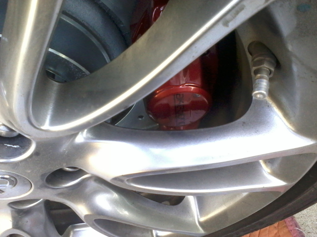

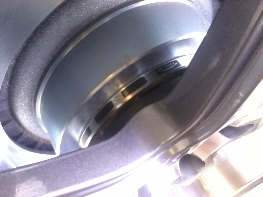

So I moved my Project Kics 10mm spacers with built in studs that I had in the front to the back, so the rear wheels could clear the calipers, if you remember. So it clears all nice now but now the the factory studs appears to be too long and won't let the wheels to sit flush on the hub. The studs that spacers are sitting on are hitting the inside of my AfterMarket wheels ( there are holes for the studs in the wheels, but holes are not deep enough due to high offset of the wheels if you know what Im talking about. ... Im gonna have to trim my factory studs now so the wheels can sit flush.

So i installed my Factory wheels on the back so I can drive for now and wow how much clearance vs my Avant Garde wheels!!!

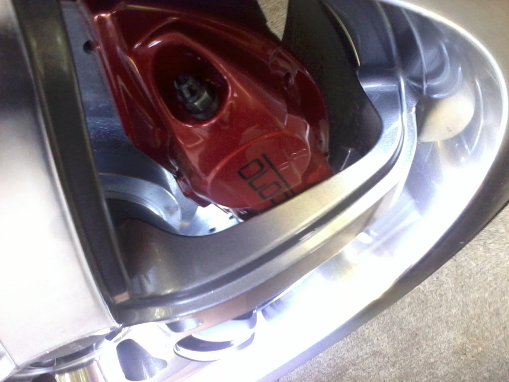

So anyway the 10mm front spacers went to the back, and my 5mm spacers went to the front... The front barely clears the front calipers, there is like 1mm clearance now! pretty scary... I do have 15mm spacers coming for the front though, but for now that's what I have.

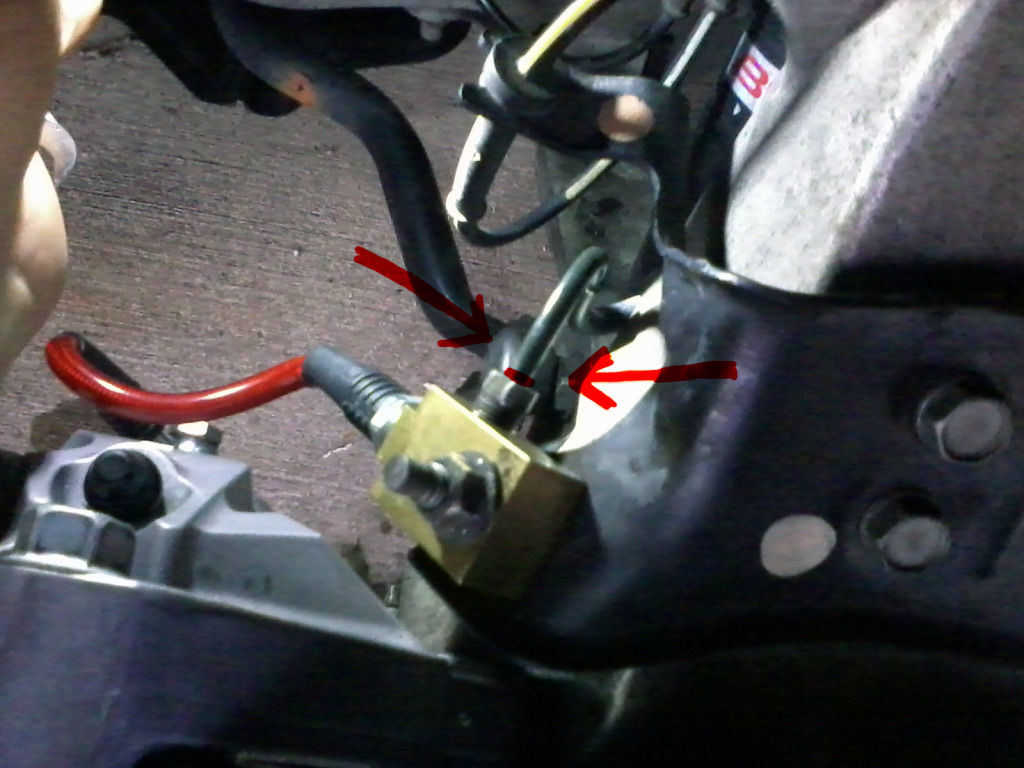

I got a leak from the front Factory line right where it's highlighted in red. I remember when I was bleeding the brakes it leaked from there as well and the other side, I tightened the other side and then this one but it still leaks from here... It leaks pretty bad too. Anyone had this problem before and WHY has this happned??? I want to get new one now and install. Hopefully it will fix the leak! Have no idea why it's leaking from there!!!
Can anyone hook me up with the part number for that line that I need??? That's the line that goes behind the knuckle. I got an 07 G35 Sport Sedan

I never had that problem when i installed mine. It looks like you might need a new line. I am not sure about that. Unless i get a better look at it.

^^yes most people have problems with bbk and aftermarket rims....it all depends on the disk type and the offset of the rims whether or not you will be fine running a bbk

Yeah it's not as common from what I heard and read but yes it does happen. I know some some people who had this issue. I didn't think I would have this issue at all, but guess what, Im one of those people. IT SUCKS!!! If you have high offset with your aftermarket wheels, you're likely to have this issue.

Shurik, I just responded to your other thread about this (https://g35driver.com/forums/6526711-post31.html). Do you know you can cut the end off the tube and re-flare it? It's not hard to do. Of course you can always replace the line entirely too.

That red line looks like it needs to be flipped it has a hard bend near the black rubber coming off the gold block..
yeah I know what you mean. I did flip it before, and it gets even worse if you flip it. Those SS lines are not flexible at all.
I just remembered that the car was hit on that side before I bought it. So the line could have been damaged once I was doing the SS lines. All other sides are great, no leaks. I did this one side same as others, and I ended up with the leak. I better change the whole line, instead of cutting. Safer that way.

That kink is there because of where the hose ended up when you tightened it into the block. The nut is a collar that spins free around the hose until it's tightened. What happens is that, as you tighten it down, it grips the hose and spins it a bit before it cinches up. Since the banjo bolt has to go in a particular orientation, the hose is forced to kink like that. If you loosen that nut, and untwist the hose all the way AND THEN A BIT MORE than it wants (and hold it there), when you tighten it up again and it gives it that final twist, you will likely be able to have it cinch up in a more relaxed position. It takes a little finesse, but it's totally doable.
Well, it's certainly your call, but I'd take a good assessment of how far that line goes back until it's next junction. I know some are really short and easy to get at, but some of them can go clear up to the engine bay before the next coupling and be a major hassle to replace.(Hopefully, that's not the case here) Also, at this point you only have one coupling that's giving you grief. If you replace the entire hose, you're potentially introducing another point of concern that hadn't been involved previously.
In any case, you're gonna need to get access to a good dealer for parts help. I found an old copy of a page I had a dealer print for me which showed the hardline (Model V36 "Brake Piping and Control" section (462- -A 02) ), but I can't make out the part numbers on it (sorry). Hopefully if they find it, it won't be a 'back ordered to Japan' situation like the simple caliper rebuild kit I tried to order was.
EDIT: wait, wait, wait . . . that's the front brakes you're dealing with there; sorry, I wasn't paying attention. Yah, that is a short little segment that just wraps around the suspension. That one is listed on the V36 Brake Piping and Control (462- -A 01) page that I can read. It looks like the part number (undoubtedly a partial number) is: 46245(right) and 46246(left).
