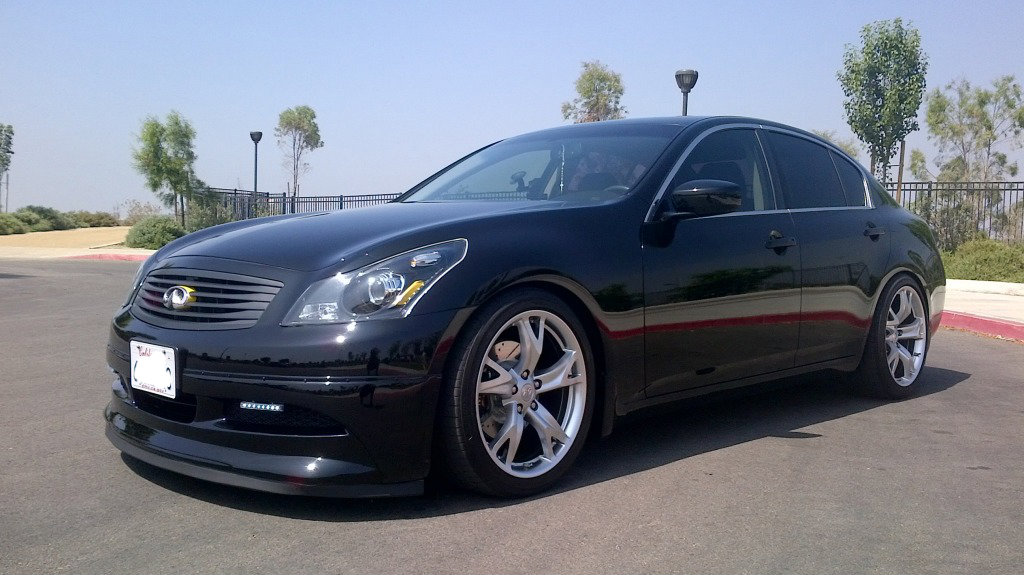

FWIW, my old wheels, pictured below, will stick out 1mm more than your rear set. These are with 285s.
Roughtly -2 camber with an Eibach-ish drop.

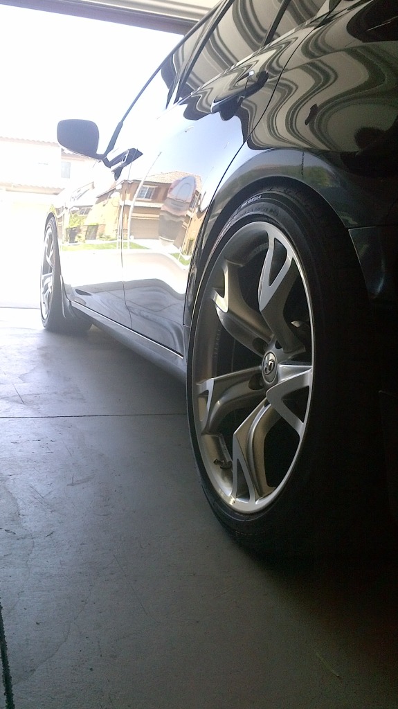

Actually in my opinion those are pretty good flush fitment for the sedan. The front I can guarantee you will be okay. Here are some pictures with the OEM 370z Ray wheels. This guy is running the almost the exact same setup you are looking for except his tires are a bit fatter and the fronts are 5mm more agressive. I say if you at least have an eibach drop like this guy, it will be sitting perfect.
09 journey sedan
370z rays forge sports rims.
F 19x9 + 20
R 19x10 + 30
Tires:
F 245/40R 19
R 275/40R 19
Suspension:. Eibach spring
[/QUOTE]
I say go for it if you are getting a good deal. Post pics up when you are done!
09 journey sedan
F 19x9 + 20
R 19x10 + 30
Tires:
F 245/40R 19
R 275/40R 19
[/QUOTE]I say go for it if you are getting a good deal. Post pics up when you are done!
