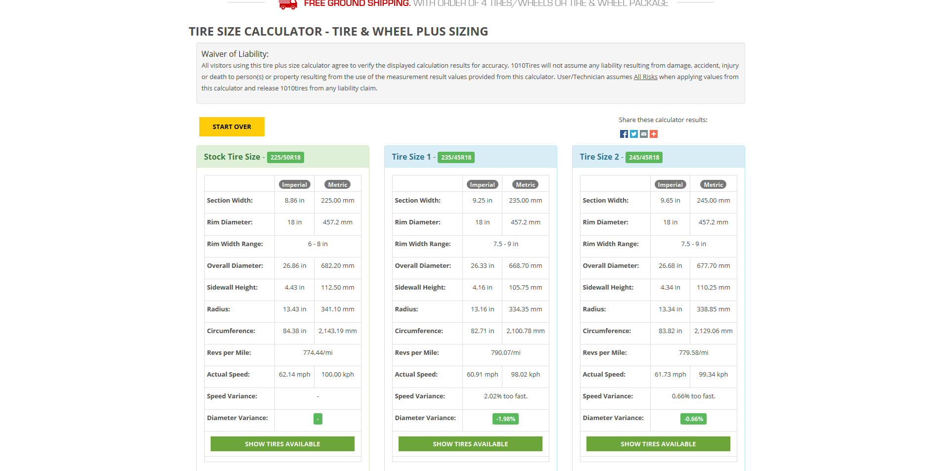

Went to 11010tires and used their tire calculator
Looks like the 235/45/18 are not a good choice as the diameter is off more than the 245/45/18 compared to the stock 225/50/18. Does this mean, even thought the 245 might feel pinched on the front, they will actually stabilize the car more and traction control won't kick in as often?
That's what I was referring to in my original post. If you go with 235's, you're going to be a little over 2% off. It will work, but you will trip your VDC more easily if you drive aggressively. Adding a 255 size in the rear at the same time returns it to very near stock diameter tolerances.

I think you used 235/50/18 instead of 235/45/18 in your original calculations. Probably why you came out with different results. What I am trying to do is go 245/45/18 all around so I can rotate them. I understand you said to change the front rims if I want to do that but I am trying to see what the side effects would be if I keep them they way they are. I am not looking for a super sport performance. I just want it to be stable and safe with out having ill mechanical effects on the car. Thanks

Ahh, you're right, I was using a 50 profile in the front in my calcs.
If you just want to run the 245's all around, you certainly can, and lots of people do. Like I said, it pinches the tire a bit when fitted to a 7.5" rim, but it's no biggie and you may never even notice unless you're really getting into some serious corner carving. If you search around here a bit, you'll see it has been done lots and lots of times, and many folks are perfectly happy with it.
With the assumption that you'll be looking to eventually rotate the wheels (as a benefit of running a square setup), you'll need to remove the bolt that is inserted into the front hubs to prevent inadvertently mismatching the staggered wheels. It will be obvious when you see it.
