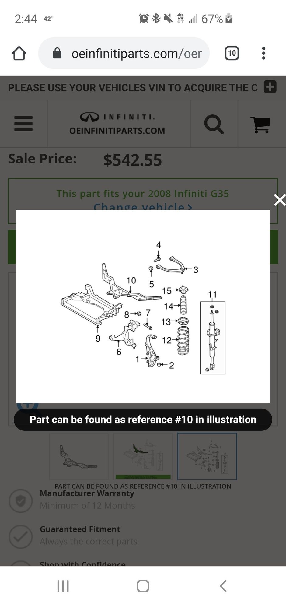

Planning on replacing my front lower subframe (I think that's the correct name) during the winter months (among other suspension stuff) and I'm trying to track down the part number.
It's the tubular frame looking piece that goes all the way out to the body on each side. I've found it in a bunch of places for the V35 chassis, but no luck finding it for the V36. I'm sure someone has swapped it before and knows the number. I imagine Cleric will chime in with the info, he seems to be a walking encyclopedia on these things

Front suspension brace? I could use one, it's one of the rusty parts of my car !

Engine cradle/crossmember? #14 in the diagram: https://www.oeinfinitiparts.com/v-20...ont-suspension

Since you said the "tubular" section it's probably the front subframe BRACE that highly susceptible to rust.
Should be Nissan part number 544B2-EG300 for the V36 platform but double check before ordering, eBay is usually a good place to source them, I'm not totally sure if there's a difference between the RWD and AWD but I THINK they're the same.
Unless your existing one is actually rusted to the point of MISSING metal you can just sandblast the one you have and prime/paint with either underbody coating or bed liner and it will last forever.
That's the one, thanks.
