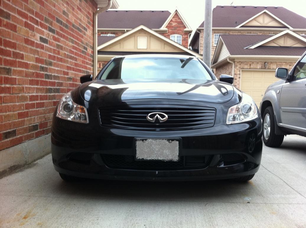

Awesome DIY, just had some trouble removing the top cover, putting everything back was a breeze.
Sanded the grill with 120 grit sand paper, then 600 grit automotive sand paper.
3 x coats of duplicolor adhesive promoter/primer
3 x coats of duplicolor perfect match universal black
5 x coats of duplicolor acrylic enamel clear coat
Black color matches very nicely.
Attached Thumbnails DIY: Grille Removal-photo-36-.jpg
