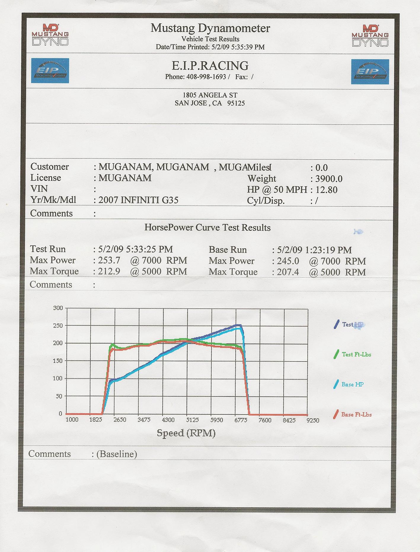

How are these Dyno numbers?
Don't these numbers look low or is it just me? Before the tune I got 245rwhp.
Attached Thumbnails How are these Dyno numbers?-scan0030.jpg   How are these Dyno numbers?-scan0031.jpg

Dyno numbers are relative.... I don't know that you can make the assumption that they are low unless you have something from the same dyno to compare to. My 09 G37 (6MT) made about the same on a Mustang dyno.... 262HP/227TQ (stock with a Cobb AccessPort).
I read in another thread, someone said, "those numbers are low... you need a different dyno" (paraphrasing, but...). A dyno is a tool to measure performance, and there are way too many variables from dyno to dyno to say that one is low or high. Even when comparing runs on the same type of dyno. Just make sure you use the same dyno to measure and tune you car, and you will be ok. You gained 8HP and 5TQ with a tune, that is pretty normal. I gained about 6HP/6TQ with a tune on my bone stock 09.

A Mustang dyno will read a lot lower than a Dynojet.
The numbers seem a tad low, but close to what I would expect. My 09 with an AccessPort tune made 262HP/227TQ. His 07 made 254/213 with Stillen exhaust, G3 intake, Berk HFC's, and Orisis tune. That seems about right. Bone stock, he should be about 30 HP less, so his mods have added around 20 HP, which seems about right. I wouldn't worry about it, but if you want to feel better, go dyno your car on a Dynojet (they read the highest).

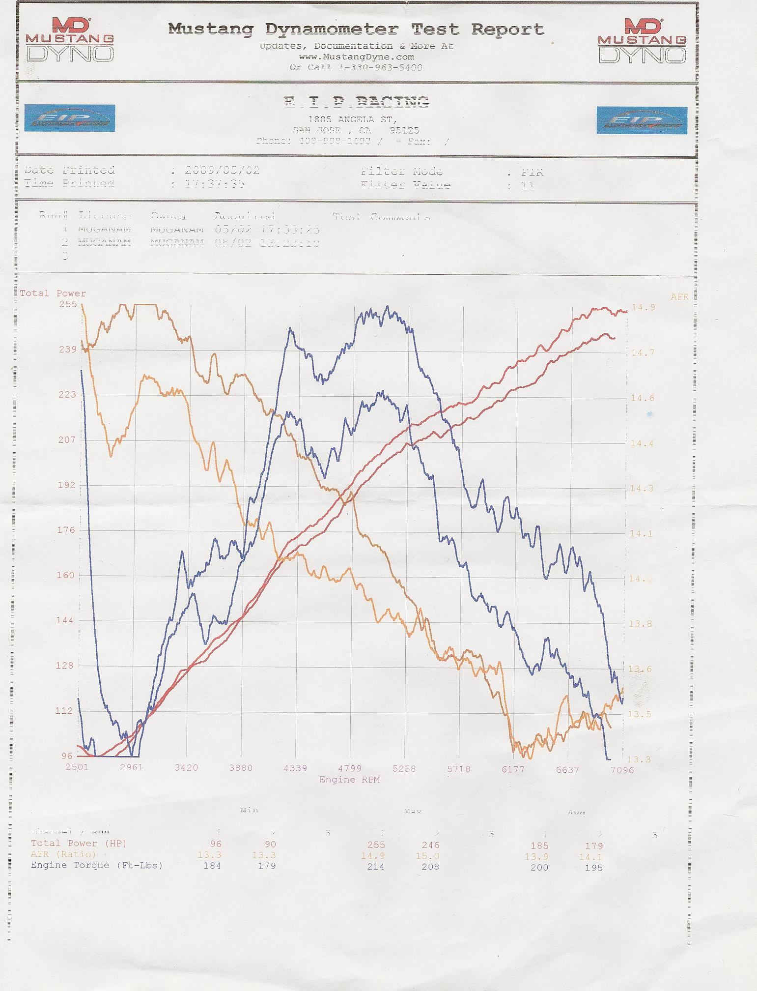

Was the AFR measured after CAT? Do you have a "TIMING" graph? Mustang dyno tends to read a lower so do not worry...

Damn dude, your numbers are probably low because your on a mustang dyno.
As for Dyno Dynamics, they can be tweaked to rate higher than a Dyno Jet. I got over 320 on a tweaked Dyno Dynamics.
Dyno Jet cannot be tweaked, the rate the way they came out of the dealer.
Different Brands on Dyno Jets will rate differently.
All Dyno Dynamics can be tweaked. Thats why its very hard to trust a Dyno Dynamics.
A mustang dyno is just a heart breaker. Unless you think you have a 1000HP, dont go on that dyno lol
But your numbers look fine for a mustang dyno.
