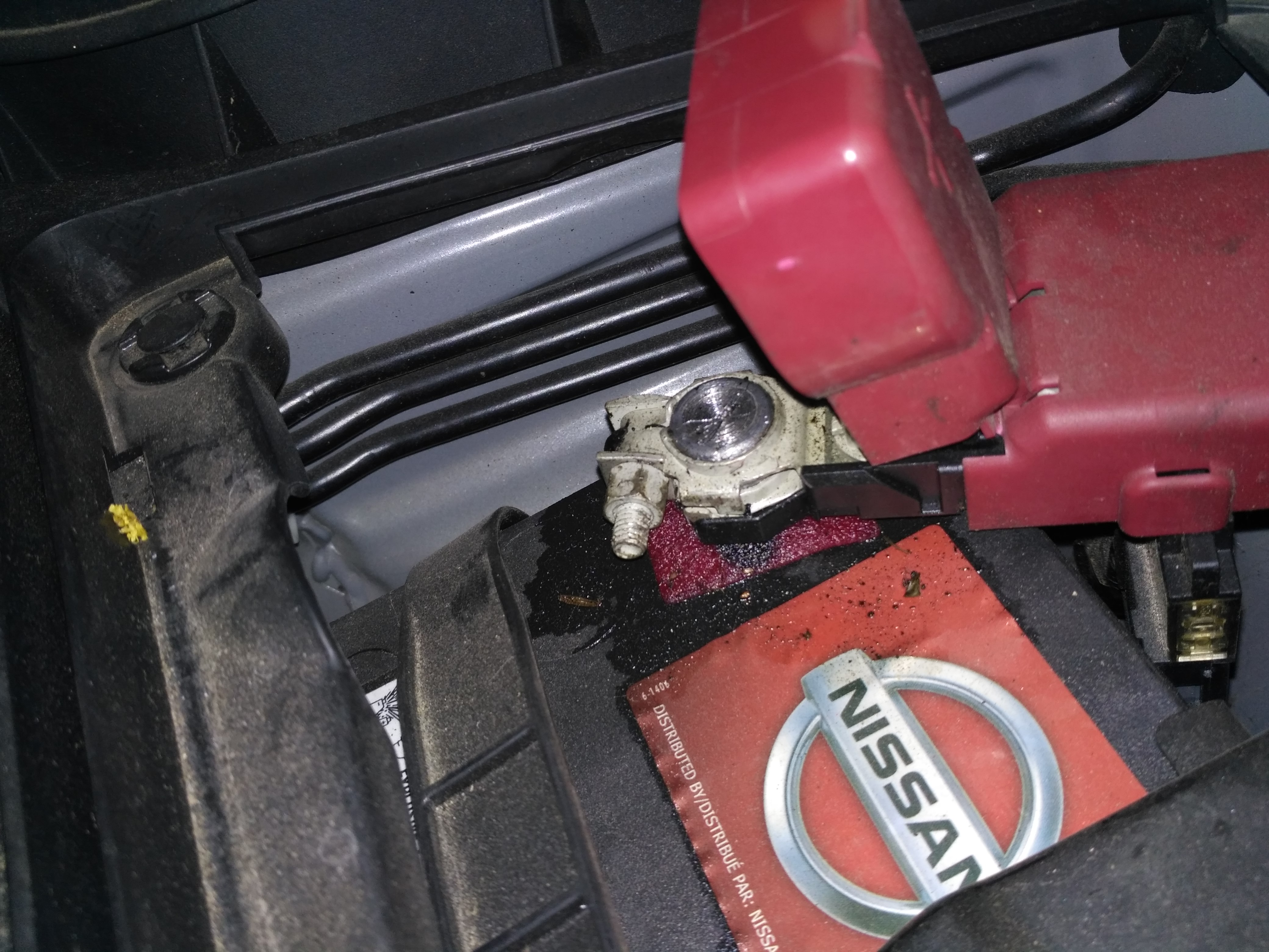

Well this is the state of my battery. Hadn't noticed it before, obviously a fair amount of sweat and grime around both poles.
Should I try cleaning it up and re-connecting or is this a sign of a battery on the way out and better to simply replace?

Battery is destroyed and leaking acid out of both posts, carefully remove and recycle it, clean the entire battery compartment with acid neutralizer being careful not to get electronic components like the IPDM wet.

New Walmart battery is in. Now Voltage drops from 14.0V to 12.9V after just a couple of minutes.

The total loss of engine power I had looks like it was due to a bad connection caused by a fouled battery post terminal. Since replacing the battery over to a new one, car is running fairly good with voltage staying at 12.9 over the past few days (only reads 14.1 for a few mins immediately after startup).
