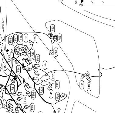

And, back to GF's car-- which I don't have right now to diagnose -- the FSM got me this far:
F54 is the connector for O2, B1 S2 and I now know how pins 1-4 are oriented. It also tells me that F54 is at the end of the engine compartment "F" harness:
Since everything else seems to be working okay and we don't have a blown O2 fuse, the problem probably lies with the connection or at least a short portion of the engine compartment "F" harness.

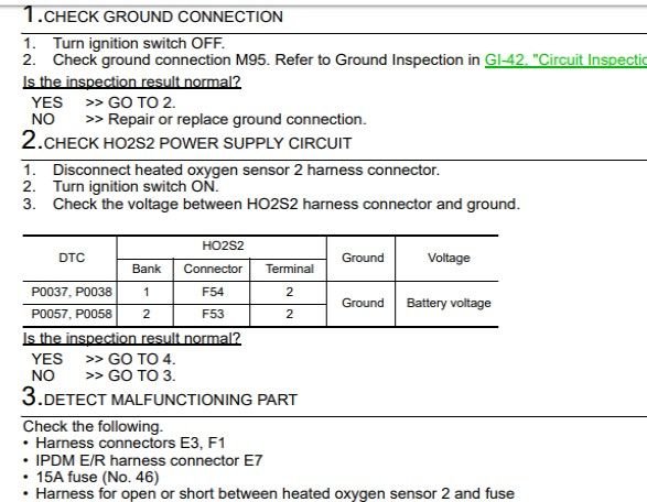

Also, the FSM says the O2 heater will active-- and trigger a P0037 code-- when warm and reved to 3.5-4K rpm for 1 minute and idle for 1 minute. Then it says:
So does that mean terminal 2 should be battery voltage (12-13V)? Sorry, I'm probably stating the obvious... I don't see anything about terminals 1,3 and 4??? IOW's is terminal 2 the battery voltage that powers the O2 heater??? But only after triggering it with high rev's followed by idle???

Here's what I've gleaned so far:
So, the F54 connection is under the car and at the end of the Engine Compartment Harness. If I'm reading this right, you can trigger the 12V input at terminal 2 of F54 by revving a warm engine to 3.5-4K rpm for 1 minute and 1 minute of idle. That will set P0037 and then you can check if terminal 2 is at 12V.
Since F54 is at the end of the engine compartment harness and under the car, it's probably prone to damage. And, since we're not getting other problems, the problem, if wiring, should be at the end of the harness and hopefully easy to find.

Again, your help in helping me learn how to access the FSM had been a great help. What I can't find is what I should see on pins 1,3 and 4 on the F54 connection with a voltmeter. FSM just says, check fuse-- which I did-- and check continuity (zero ohms) between F54 and ECU-- a big pain...

No worries, there will also be line diagrams for each circuit that have pin numbers on them. For example, if you use the table of contents in section EC - Engine Controls and it refers you to harness then you can go to section PG - Power and Grounding to see the actual circuit.
You already found harness F54 for the O2 sensor and yes it's saying that pin 2 will have battery voltage. Underneath the column for "ground" it might tell you an actual point to test, when it simply says GROUND you can test against any point of the chassis. So using your multimeter on GROUND and terminal 2 the expected voltage is BATTERY VOLTAGE.
Lots of stuff runs at 5v on these vehicle though so be sure to check that column to see what's expected.
Harness F101 for the ECM is located in PG - 13. Don't confuse F101 and F102, F101 is the wiring harness, F102 is the ECM itself, but they are both listed as "ECM" in that section.
