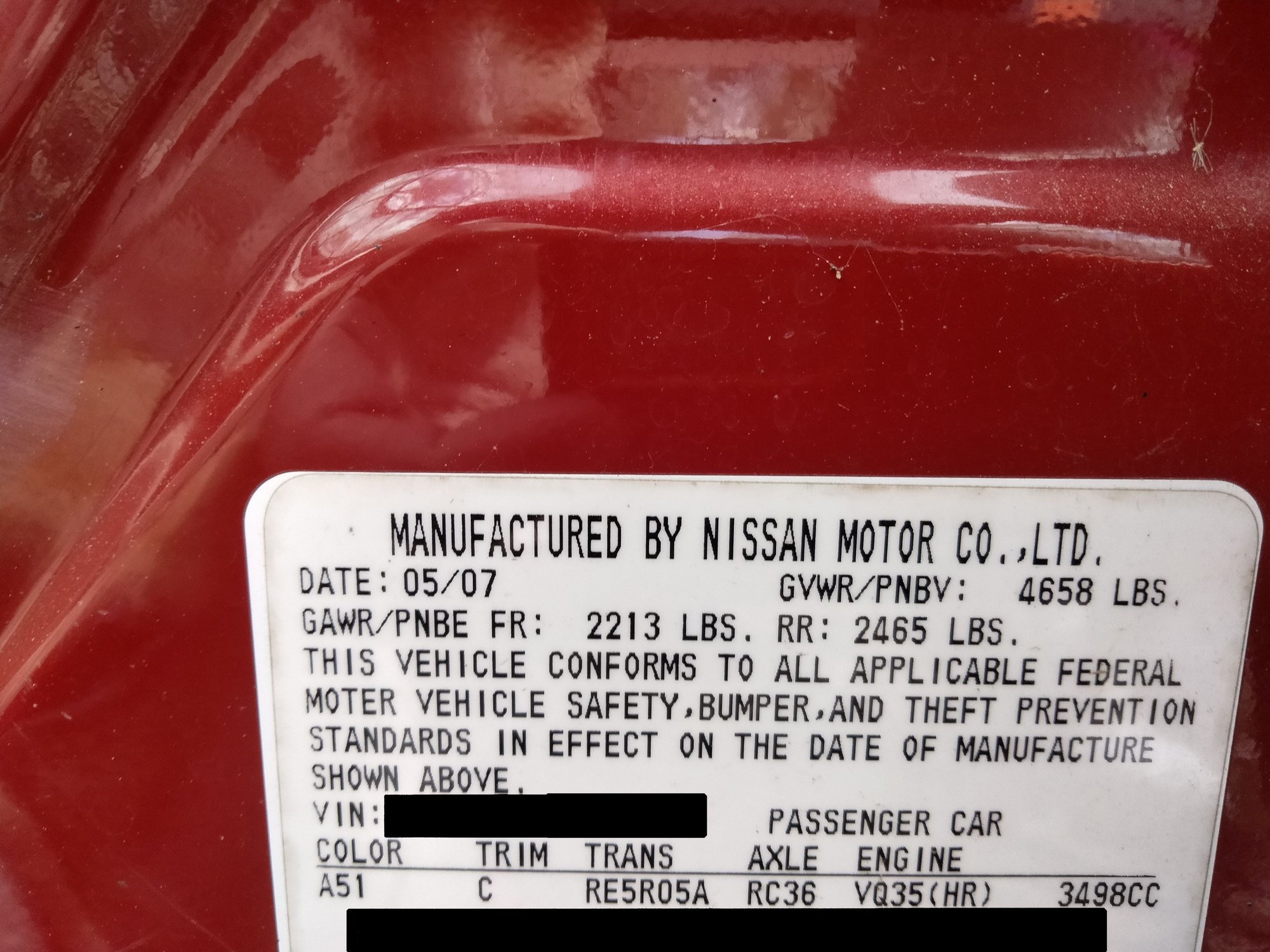

Brother, these days we are living in, I ain't 100% sure about anything. I will say that it would be hard to do, the way they are laid out on the harness. Add that to the fact that I did them one at a time and I'll say that it would be highly unlikely. I tried to send a video but the file is too large. It was audio of it idling then it would surge, then level out for about 15 seconds then drop RPMs and idle rough, then pick up and smooth back out. I took the intake plenum off today as I have to change valve cover gaskets anyway. The gasket had some flat spots in it but didn't look like it had been leaking. I will be changing it though. An interesting thing happened when I turned the plenum over, dirty green fluid came out of what looked like a vacuum line connected to the throttle bodies. I have no clue about that. I'm gonna check the cam pos sensors and exhaust position sensors and depending on the price, may change them anyway. At this point, I'm thinking it could be an injector. possibly? Or maybe an ECU? Did I mention I hate the new crap? It's great before a hundred thousand though and it sure does look good sitting in the yard. -Bob
PS- My engine code is VQ35HR not DE
