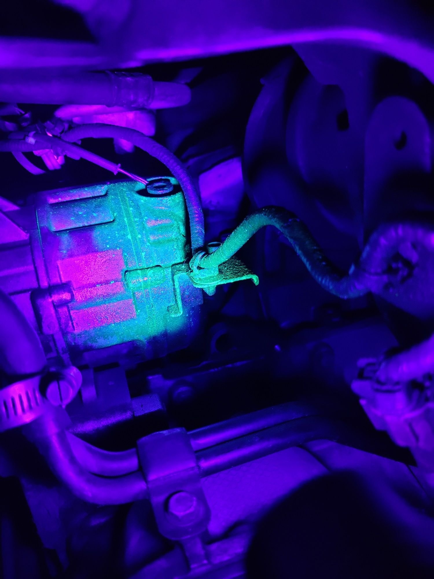

The other day tried turning a/c on and didn't feel the compressor coming on. After conducting all the tests described in the fsm, decided to order a uv light and the whole backside of the compressor looks like a glow in the dark party (pic attached).
Appears to have leaked out from the control valve/solenoid. Has anyone run into this before? I assume i could try and source the valve, but what would trigger it to go kaboom like this to begin with? A/C was always blowing really cold before.
if I do go the route of replacing the compressor and drier, would i need to mess with the expansion valve? Appreciate any input.

ended up replacing with an OEM compressor off ebay (looked exactly the same) along with the dryer. will keep updated if anything changes.
disassembled the old compressor, but couldn't see any clear indications of what failed. inside housing had a few marks of where it could've been touching a little, but inside was very clean otherwise.
