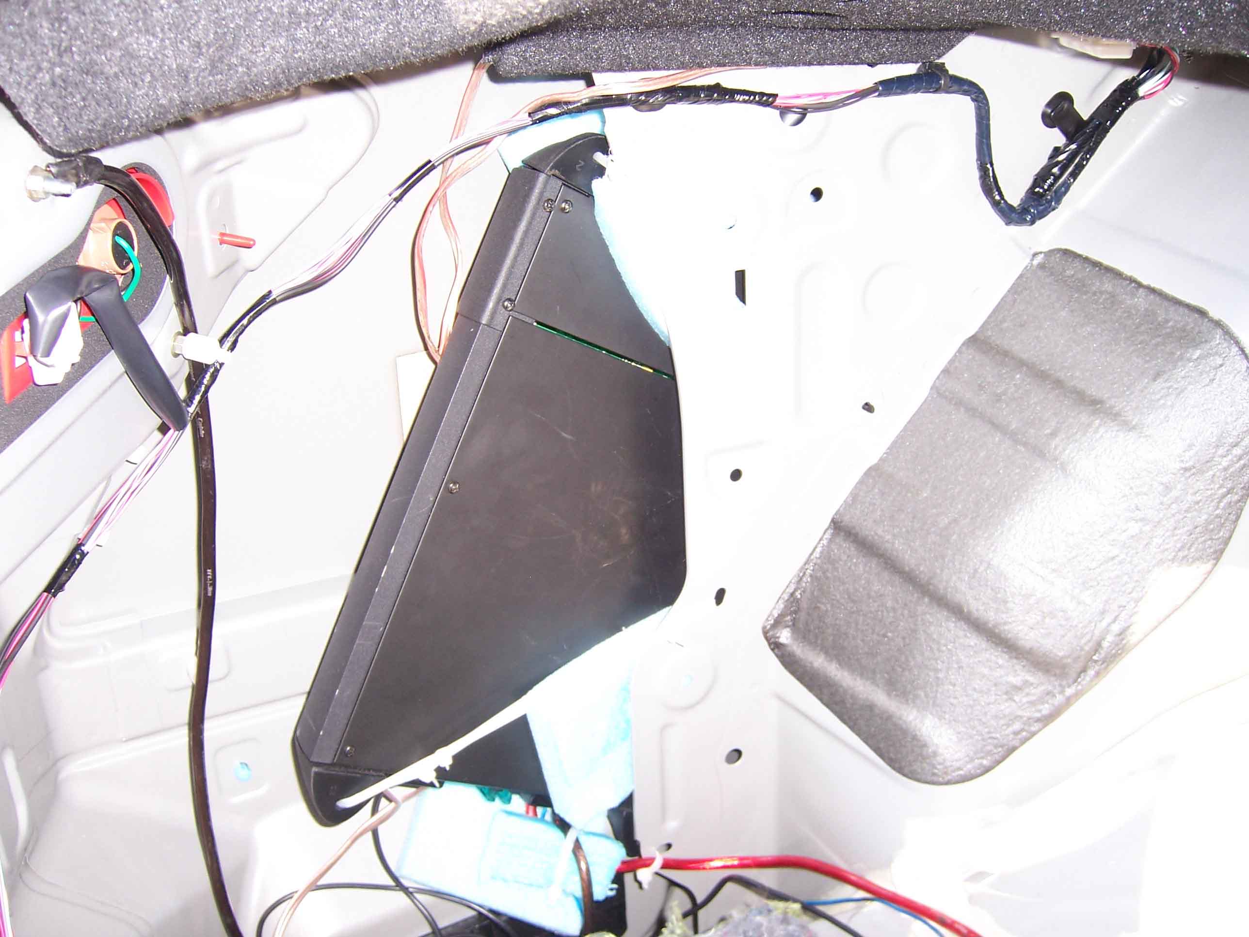

So today I had some free time and decided to play a little more with my g35. I know that the 400 watt SOW system with 3 10" subs sounds pretty good, but i decided to throw in a fourth
i had a 700 watt rms MTX class D (600.1) amp sitting around and a new 10" pioneer premier competition sub in a fiberglass enclosurefrom my 2006 sedan.
Well then an obvious solution ... it must be installed ... so I decided to tap into the bose amp wire up the amp and hook up the woofer.

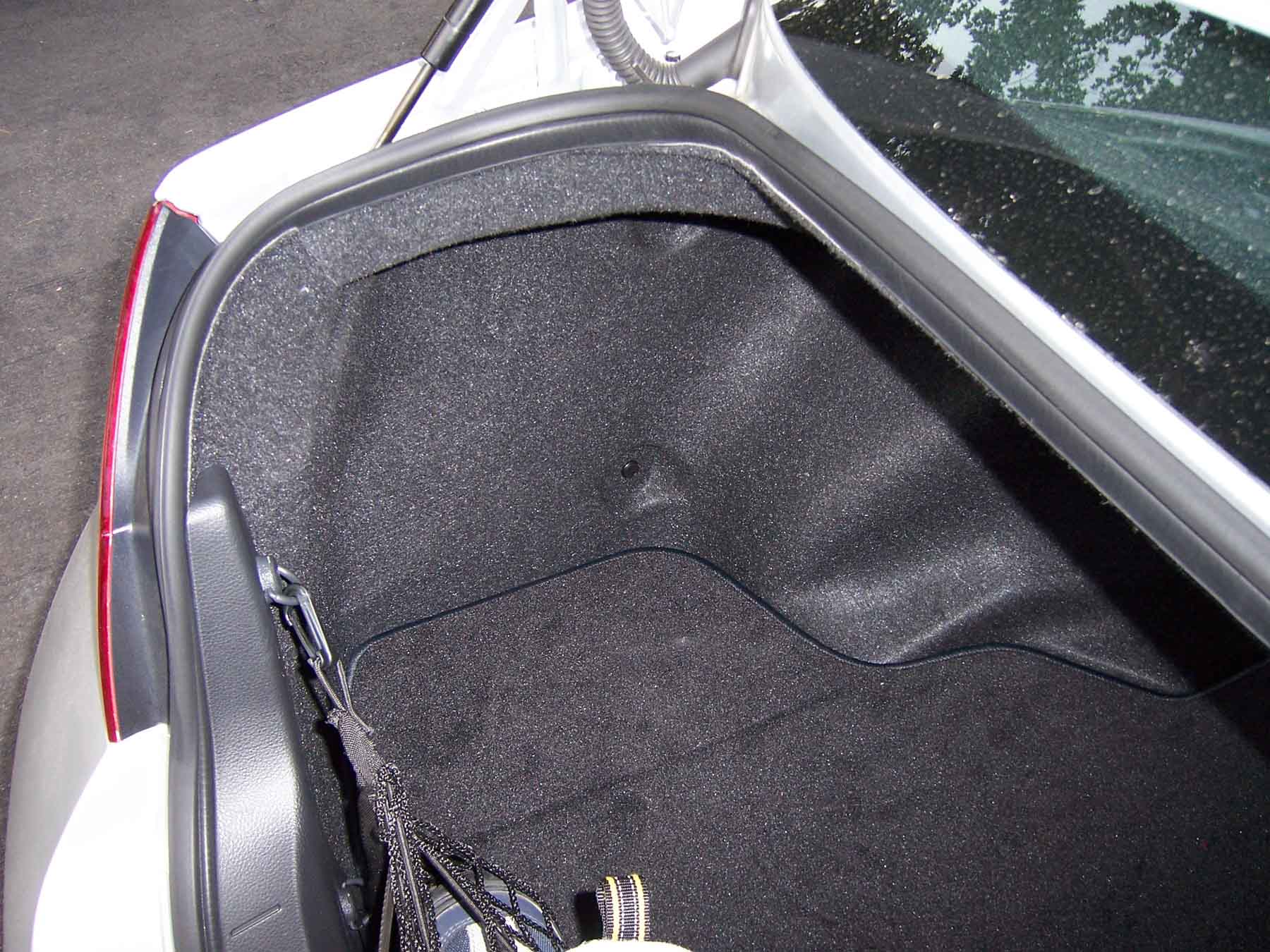

The reason I did this, was that I realized that in the 07 there is a perfect amp space behind the trunk liner (see pic 1) so i pulled out the lining ran the wires and hooked in the amp. I decided to use foam and zip ties to create a home for is as to not have to drill and holes in the body work.

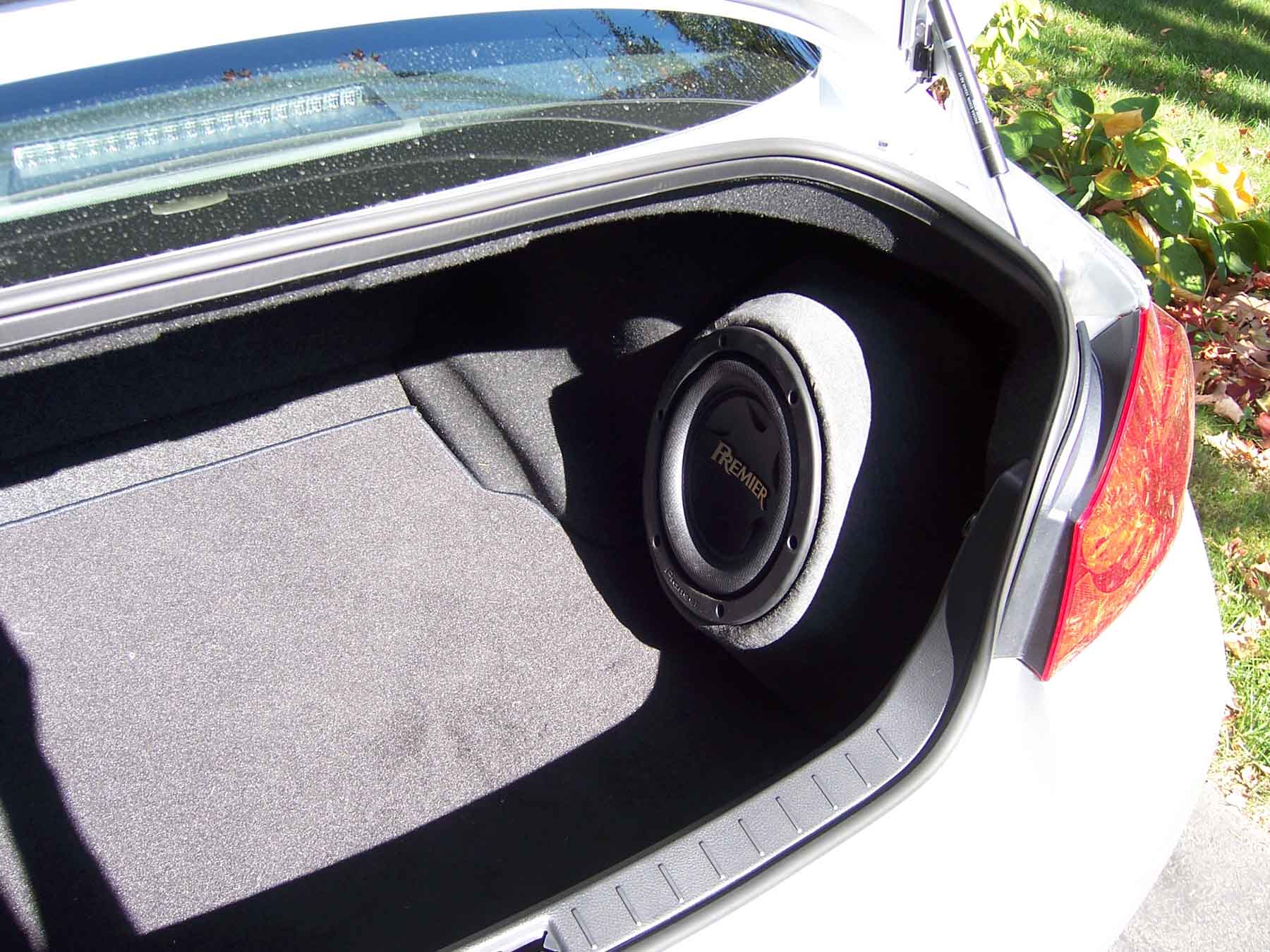

The amp fits beautifully and you never know its there (pic 3)
Overall the sound is noteably better with a much stronger low end. The only thing i dislike is how much the trunk rattles on this car ... sigh ... i guess matting will come next .
Also, I made the enclosure for my 06 sedan so its not a perfect fit (but pretty good). It'll do unitl I make a new mold
So now i have 1100 watts and 4 10's ... overkill ? nah
