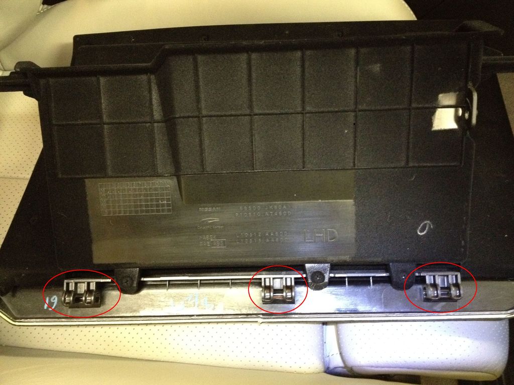

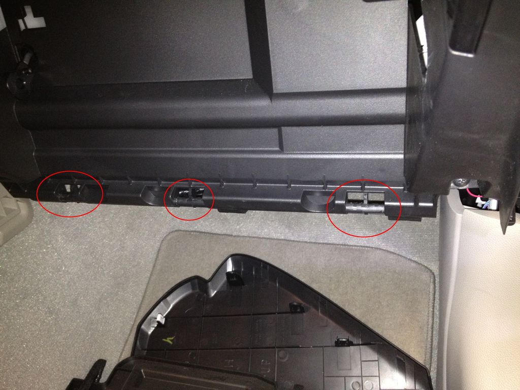

I found removing the glove box a little difficult. I didn't want to use too much force for fear of breaking something, but eventually figured it out. Here are a couple of pictures to give others an idea of how the glove box is hinged.
Back of the glove box:
The area behind the glove box:
Put your hands on the bottom edge of the glove box and pull out towards you and slightly up, and it'll come off the track. I found it easier to do it one side at a time.

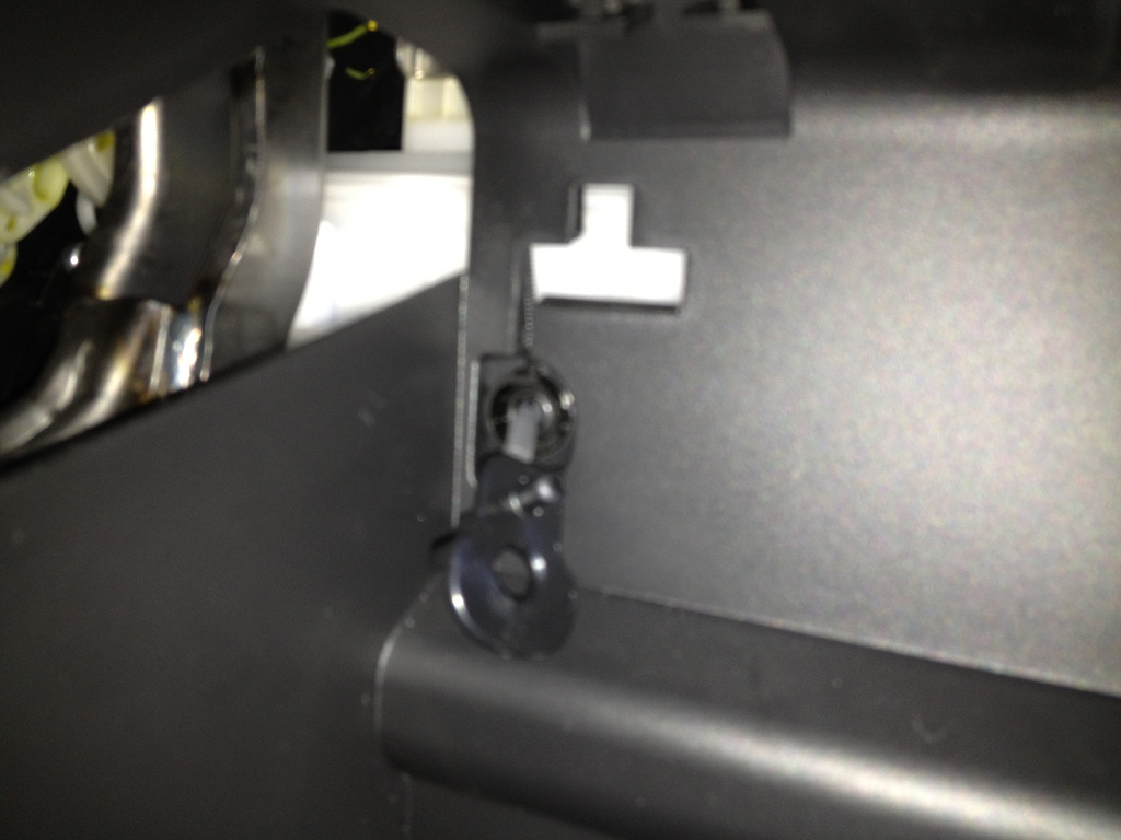

There's also a string on the left side of the glove box that provides the soft open feature; you need to disconnect this to move the glove box completely out of the way.

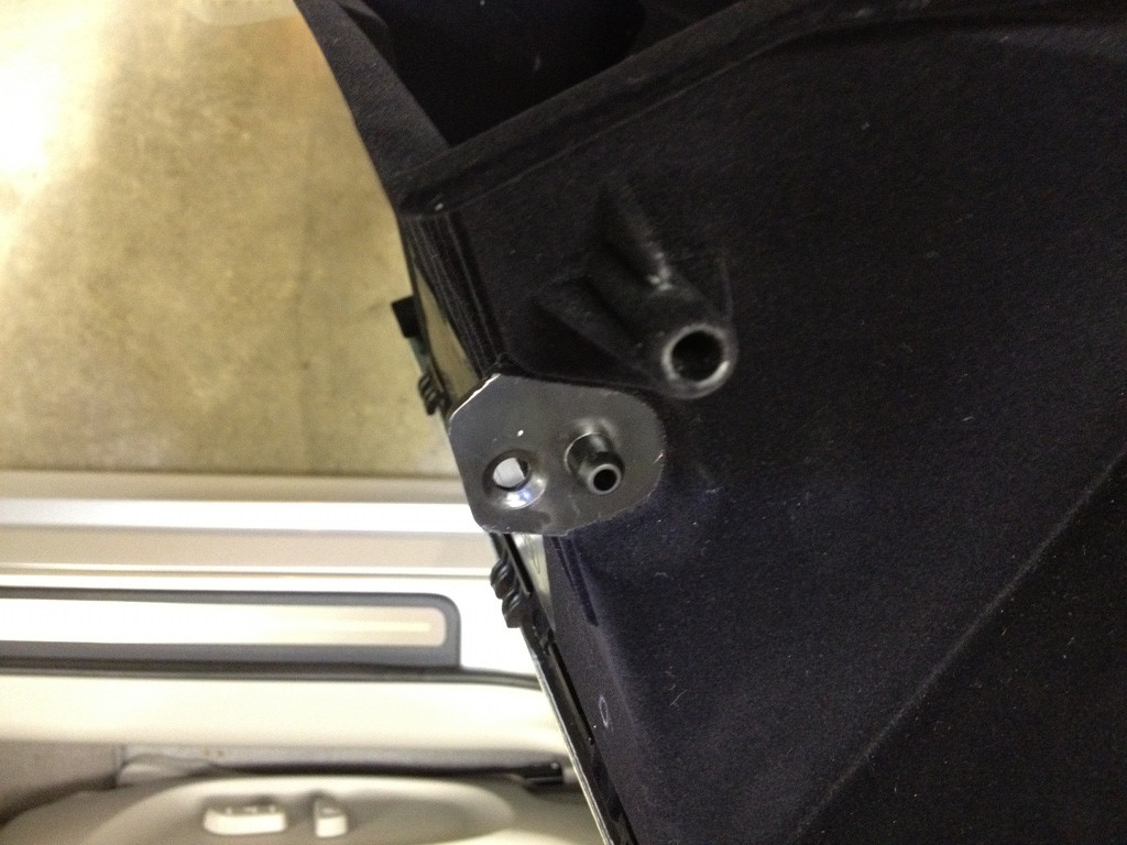

The string is connected to a bracket that has a hole and a peg:
(I apologize for this blurry image. I didn't realize it until I was done swapping the filter.)
Here's where it's attached on the left side of the glove box:
The peg on the bracket connected to the string has a split in the middle. It's the type that expands when inserted into a hole--you need to squeeze the peg to get it to come back out.
