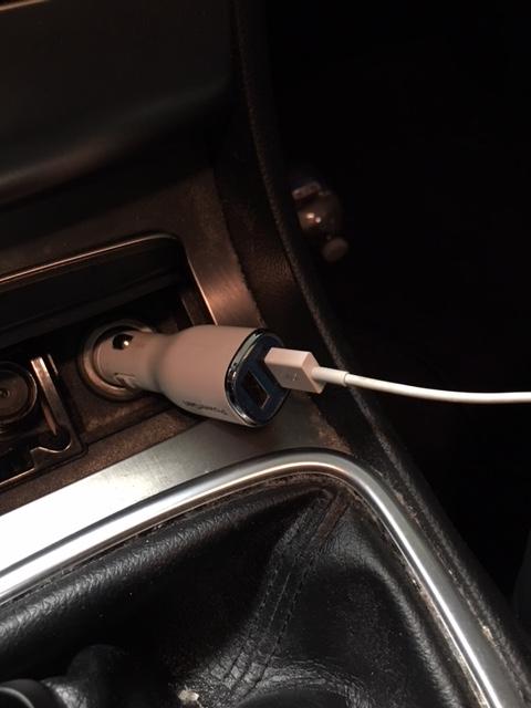

oh man you could have fried your phone lol. USB is 5v not 12 as you know now.
Why don't you buy one of these and call it a day?

I use the same one as Yosip pictured, it sits practically flush with the cigarette lighter which is nice.
Amazon Amazon
