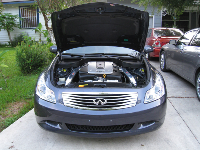

I have had no trouble with this mounting position.
Attached Thumbnails For those of you who installed HID kits on the fog lights-img_0995_g.jpg

just make sure that they are not touching anything as they do get very hot when they are on. That is why i placed them on top so they are out of touch.
