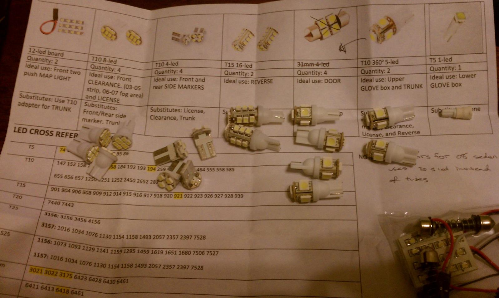

What size is the bulb for the glove box for a 2007 35x? I checked the Sylvania site and there's no mention for the Glove box. That's only one I have to change left.
Any help would be appreciated.
Thank you!
Sean

mine said 'T5 1 led' it's round and very different from the rest. Attached is the pic of the sheet I got from hpun who has been selling them on here in a kit. It's pictured in the upper right.

The bulb number is 74.
