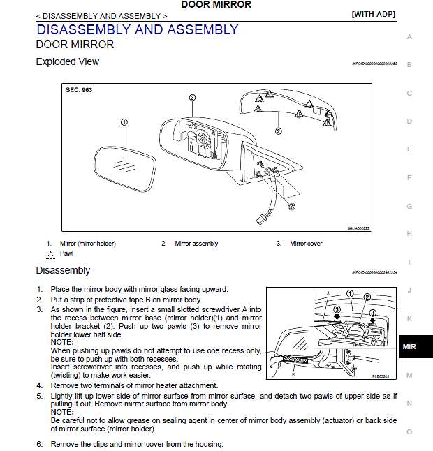

anyone have any experience removing the mirror cover? im referring to the main painting one, not the little one under mirror assembly.
my mirror is busted and im trying to salvage the cover so i can put it on the new mirror assembly. the cover comes unpainted from dealer.

Are you referring to the side rear-view mirrors on each door?
Old Jun 17, 2009 | 09:35 AM
mifesto's Avatar
Posts: 106
yes, the side mirror.
in the service manual, MIR-99 shows the cover im refering to.

I believe they just snap on, but you can PM the guy from this thread if you need details.
In the service manual, mir-99 shows the cover im refering to.
Larger view

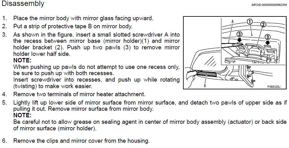

07+ g35 sedan mirror cover removal-1.jpg07+ g35 sedan mirror cover removal-2.jpg

yes i have the service manual as i said in my previous post. i need some advice on how to remove it without damaging it. it seems fragile.
