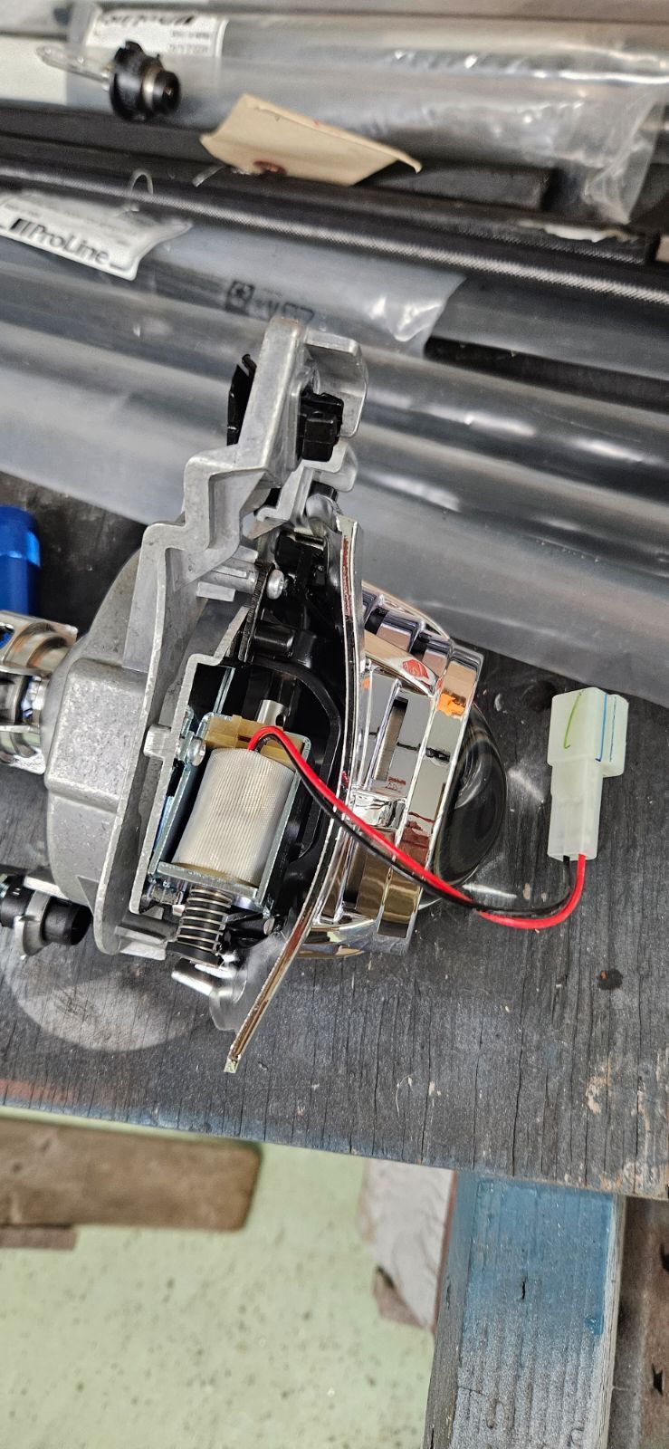

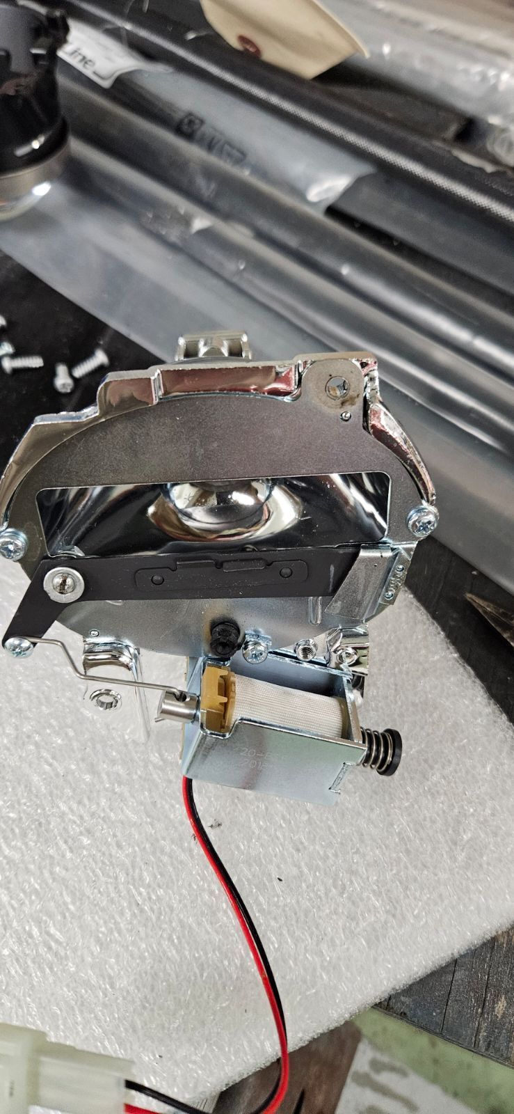

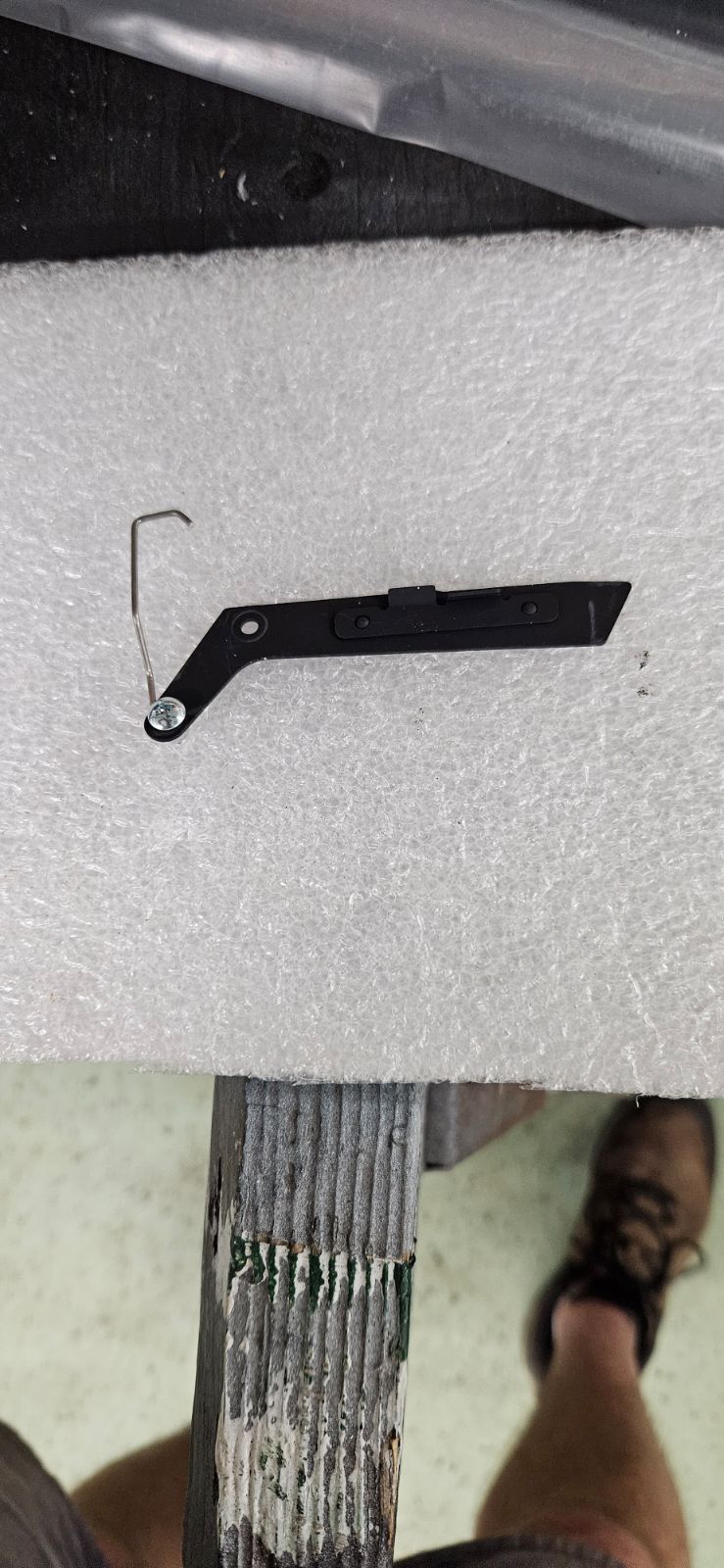

Well I dived in and took off the bumper and pulled out the headlight assembly. What a chore that is!
I baked the assembly in the oven at 200 degrees for 10 minutes and separated the lens from the housing.
Once I took apart the high/low beam sub-assembly I found the solenoid and 'flapper'. It turns out the screw and nut that holds on the spring-loaded flapper had come undone.
THAT is why the high beam wouldn't work, when I had a functioning solenoid. G2B35 was correct on what might have happened. (see post # 13)
All the parts were still loose and floating around inside the lens. I put it back together, then tested the lights. I now have a high beam again, and should be able to get an inspection sticker. Tomorrow I will polish the lens using Mother's paste and then put the whole ding dong front end of the car back together. Hope everything will still work.
Here are some pictures of the solenoid, the flapper and the way it all goes together.
This will be a 5-hour project from beginning to end, but it was necessary in order to have a functioning high beam for annual state inspection purposes.
Holy crap on fire I can only imagine how much a shop would have to charge to either fix the original lens or replace the entire headlamp assembly with a new one. Probably would be a $700+ repair bill. Yikes!
