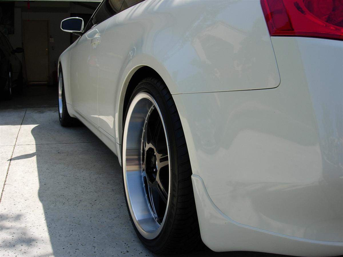

Here is mine on Stern St-2 20s
I am very glad i went with 20s, 19s just wouldnt fill in as much gap. Plus tires are cheaper.

that looks sick, doc... what size tires did you go with on the 20s? what was the offset of your stern's?

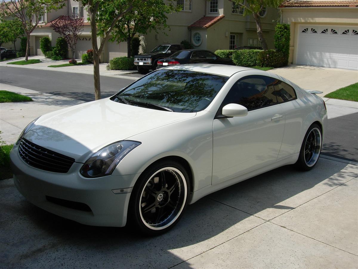

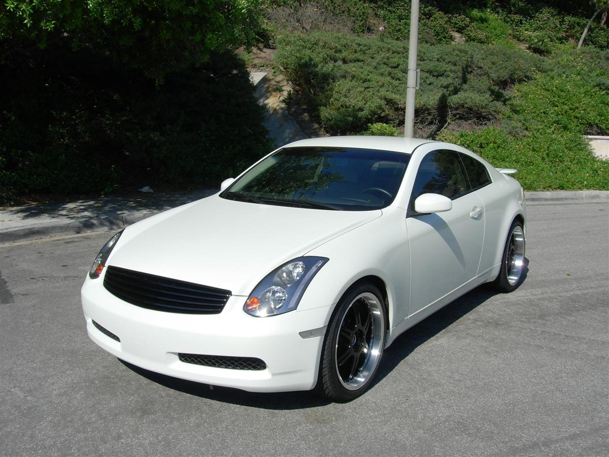

I got Falken GRB 451 tires
255/35/20 front
285/30/20 back
Offsets:
20mm front , 2" lip
25mm back, 3" lip
No rubbing at all, but my car is not lowered. Tires are pretty quiet and grip really well. Here are couple more pics.

^ I added 2 more pics.
According to a tire calculator, the difference between 285/30 & 275/35 is only about .42 which is probably not enough to save the rim anyway, but one of the reasons i went with 285 is because the tire is not as stretched and the "rim protector" is actually further out, so it protects the rims a bit better. Plus 255/35 & 285/30 keep the ratios close. If you go 245/35 & 275/35 it will throw off the ratios, but most members here havent had a problem with it yet.
I havent had a problem with bending the rims, there seems to be enough sidewall height to cushion most bumps and dips. The ride seems same as stock.
The wheels do feel heavier, if you are worried about performance loss then these wheels are not for you. The rims weight 28 lb each + tires.
