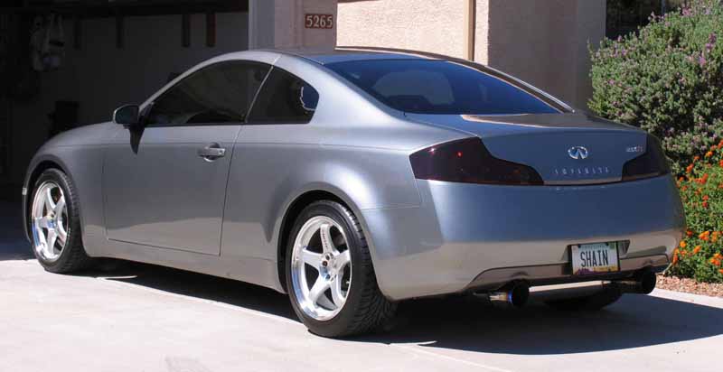

I've got Dunlop SP Sport Maxx, prior to that I had SP9000s. BTW, I'm running Nismo wheels with 245/40/18 and 275/40/18.
Lou
Attached Thumbnails 04 Coupe - Replace Tires w/OEM 18" rims-painted-bumper0.jpg
