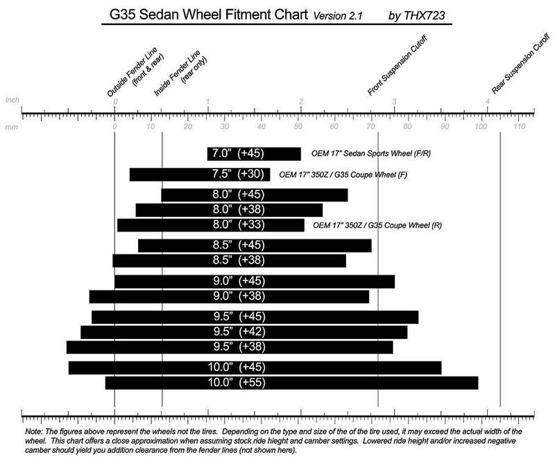

Enjoy

Originally Posted by G35m@
Enjoy
That chart is pretty much useless, alot of wrong info on it...
Go for the +38, it'll almost line up with the fenders.
What values exactly are inaccurate? The chart just doesn't account for tires or camber.
+1
If I used that chart my wheels would not fit on my car.
Then what good is it?
Where is the car when this chart is valid? On a lift? The car comes with negative camber from the factory.

You have to have some sort of standard measurement though. The chart is a quick reference guide that shows a snapshot of the widths at 0 camber. How you shift the bars on the chart depends on each particular setup (drop height, camber, etc).
You're right though, this chart is limiting in the sense that it lacks complete information. It'd be nice to have a more detailed guide that takes into consideration the different setups.

bert039, what values exactly are inaccurate? Pretty much all of them. From my own experience:
FRONT: 8.5" +38, it's still a few mm from the fender line, chart says it will stick out.
REAR: 9.5" +45, the rim pretty much lines up with the fender, chart says it will stick out almost 1/2".
My car isn't lowered, the suspension is completely stock and I have those results.
