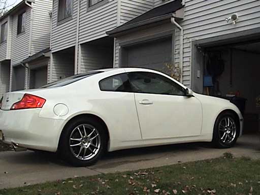

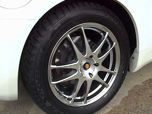

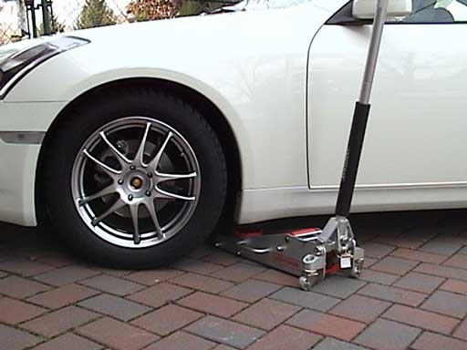

Go with 17's. You will have a taller sidewall on the snow tires, and in turn will aid in traction and overall winter weather performance.
I put 17" ASA KA3's w/Dunlop Winter Sport M3 tires on my car.
I sacrificed a little in the handling dept, but not a significant amount.
The taller side wall gives you more rocking motion in tight cornering, but nothing you can't get adjusted to.
I went with 225/55/17's all the way around, and no problems with the VDC/ABS systems at all. This set up allows me to rotate the tires, since I used to do about 12,000 miles during the winter months.
If you don't drive alot, go with the staggered setup. I believe its 225/50/17 front and 235/50 17 rear
only problem was the TPS light would come on now and again if I drove for more then 30-40 minutes.
