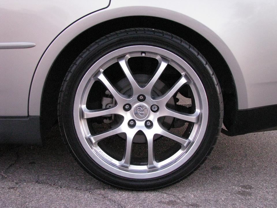

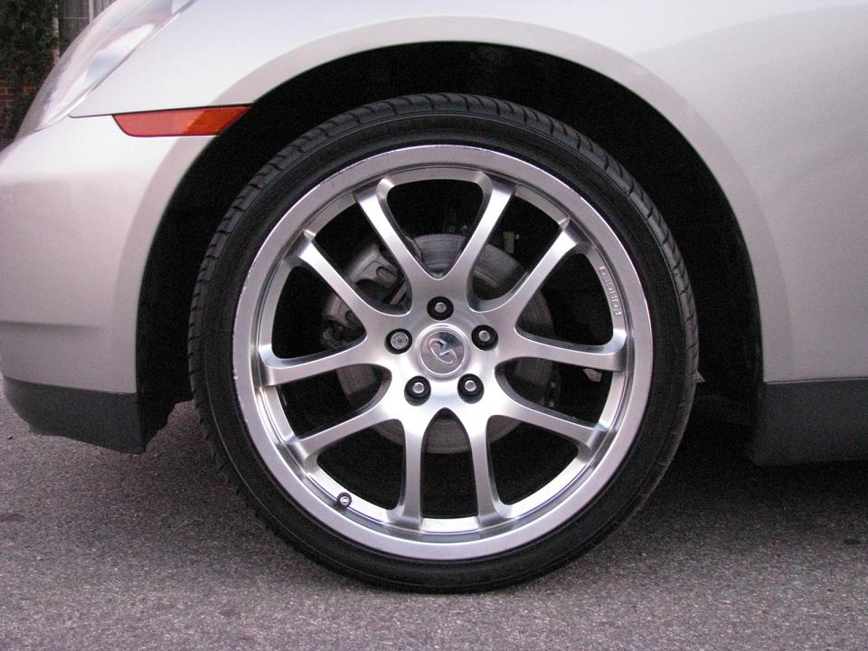

Yes, I went with the 245/35-19 front and 255/35-19 rear. They don't rub at all now, even while going over large speed bumps or hard cornering. The ride is a little less forgiving with potholes and such, but I guess thats the price to pay for 19's.
wow, thats on the stock suspension? That looks really good, even with the stock height. I know the lowering-purists may disagree, but this looks very good to me. This means that I won't be in a rush to lower, but if I do, I will go very conservative!
thanks for posting the pics.
