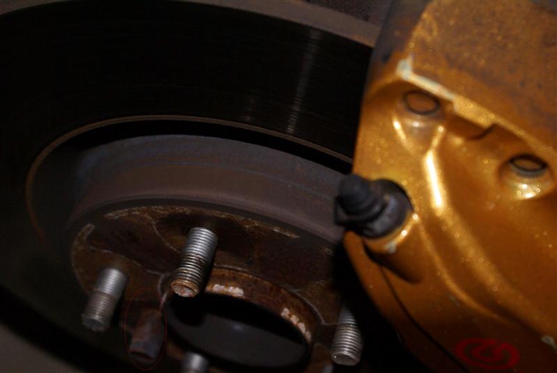

Hey Guys,
Can someone tell me what the screw at the bottom of the pic on the hub is?
You can see it's different to the wheel studs/ What's it for?
I've checked the 04 service manual and can't find a pic of it on the drawings of the hubs.

So you dont put the rear wheels on the front of the car.

Good stuff, does that mean it can be removed?
I read somewhere that a dealer said it had no bearing on wheel safety at all.
The reason I'm asking is that i have a set of 350Z SF Challenge and that screw is in the way.

Yes, it has to be removed to install aftermarket wheels. 12mm socket or wrench and voila!

Mate you are a life saver. i was having mild heart attacks
I'm in Australia, and this is one the first sets of Volks anyone has in the country for a V35 so not much local knowledge. Actually none. I took them to a wheel place which said the hubs where wrong but when i got home I tried the rears and they fit, but the front was catching on the bolt.
