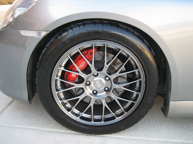

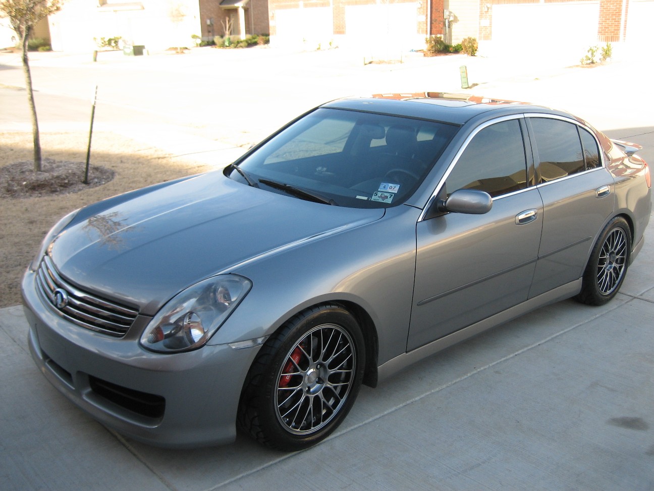

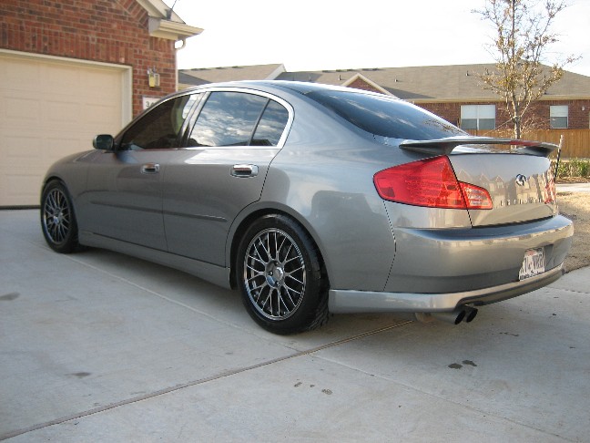

My 18's.....
Attached Thumbnails Rims For My "g" What Size Is Better?-img_0668_small.jpg   Rims For My "g" What Size Is Better?-front-wheel_small.jpg   Rims For My "g" What Size Is Better?-side_small.jpg

Also, to comment on a couple of the previous post. I think a 45 series tire on a 18" wheel, or a 40 series on a 19" is a good idea if you are NOT lowered and have some rough streets.
If you are lowered with those sizes, there is a good chance you will rub. I have run both 245/40/18's (twice) and 245/45/18's (twice) lowered on the 350Z Nismo suspension. I am really close to rubbing on the 45 series. I actually added a 1/2" spacer for some extra rear clearance. My wheels are 18x8 with a +35 offset which is not very aggresive. It just makes me think that a wheel that is even slightly aggresive, with a XXX/40/19 or XXX/45/18 will have a pretty good chance of rubbing.
Staggering your wheels will look good, and will help with traction off the line, but the affect it has on handling is debatable. You can make pretty good arguments for either (staggered vs. non-staggered). It produces more understeer (see the SportCompactCar where they did the suspension tech. on a 350Z, the link is below). You also loose the ability to rotate your tires. If you are like Ttrank, with an extra 100+HP via turbos, the extra meat in the rear with the stagger is great. If you are like most sedans out there, unless you want that look, there are as many advantages to a non-staggered setup (less understeer and you can rotate your tires). I personally like the staggered look, so I say it is a toss up. I really just wanted to point out you can go either way with the staggered thing and make yourself feel good about it.

OK, let me clarify. I am NOT using a wheel spacer. The spacer is a urethane spacer on my rear springs to raise the rear of the car about 3/8". If you run any type of 350z suspension (In my case the Nismo) the rear will sit lower on a G sedan. This is why a lot of people use G coupe sport springs on the rear, with Z springs on the front. The Nismo suspension sits close to 1" lower than the Z suspension you have, and your fenders are rolled so I don't think you are comparing apples to apples. I don't really see the need to roll your fenders if it can be avoided. That was really my point. If you select the right wheels, tires, and springs there should be no need. If you run the larger series tire with an aggresive wheel or lowering it will rub.
