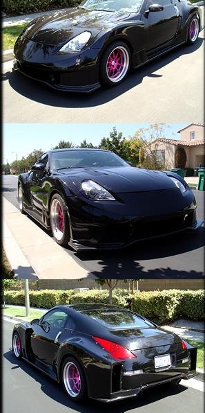

Not with a good fender roll. I don't think you understand how wheel specs work. BBK fitment is a function of the pad height used, not the offset. You ordered a 19x9.5+25 which is a high pad with a 59mm front lip. That is going to be quite sunken compared to the rear. You could have instead ordered a 19x9.5+12 which uses the same high pad so you would have the same BBK fit, plus a 72mm lip and flusher fitment like the rear. In the rear, you ordered a 19x10.5+18 normal pad with a 97mm lip, okay fitment, but could have been better if you went with a 19x10.5+5 or a 19x11+11 which would have the same bbk clearance as the set you ordered plus a 110mm lip. The 245 on the 9.5 is going to be more stretched than the 285 on the 10.5 so I would have gone with a wider rear for a better look. Still some sweet wheels though, just kinda sad that they could have been even better
hmmmm...dont forget to mention that its gonna cost more... wider than 285? how much extra? 11rear width how much extra? 10.5front width how much extra? you do the math...dont think it is neccessary to put 295 or 305 who put 295 or 305 on rear with the stock quarter pannel?
my friend`s wide Z put 285front 305rear its just bit of too much for stock body...
Attached Thumbnails Just Ordered...What do you think??-asdasd.jpg   Just Ordered...What do you think??-asdasd.jpg   Just Ordered...What do you think??-asdasd.jpg
What are you talking about? I never said anything about changing tire size, and the extra cost of an 11" wheel compared to a 10.5" wheel is only $20/wheel. Where did I say anything about a 10.5" front width?
295/305? On a widebody 350z? WEAK!
My buddy's 295/315 setup, on a stock body Z!
http://www.my350z.com/forum/showthread.php?t=336970
Precisely. I love the wheels and the finish, just wish you would've gone wider and/or lower offset. Def should run a wider tire in the front, like a 255/35 or 265/30. If I ordered up a set brand new and waited awhile for them, I'd spring the extra what...$50/wheel to get exactly what I want. You already spent around $3500, what's another $200-300?
