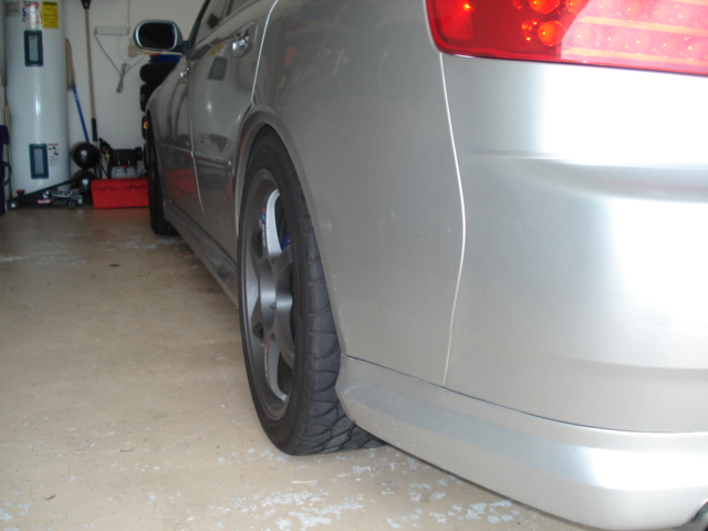

i have a 9.5 +45 with 275 in the rear and i was lowered very low on almost stock alignment numbers. i raised my coils .5 inch all around dialed about 1% neg camber in the rear and have never rubbed again. i do not have rolled fenders.
i am thinking on upgrading to either a 10 or 10.5 in the rear and i'm trying to find the best offset for that.
Depending on the manufacturer of your tire you got lucky there. For example pirelli P6's are 10mm more narrow than an RE050 for the exact same size tire. I know many 275's that would not have worked on a 9.5 +45 with non rolled fenders, or even with rolled fenders for that matter. In fact I would love to see pictures of that if you have any because I'm having trouble believing it. Even rolled you should be on a 1-2mm gap.
Old Jul 22, 2008 | 09:37 AM
G35sedan03's Avatar
Joined: Apr 2004
Posts: 1,567
From: Temecula, California
i got bfg kdw2. tirerack lists the section width as 10.9". i'll try to take some pictures, but i can assure you, no more rubbing.

Thanks, would love to see it. I guess my 05 is just weird. It's rolled almost flat and a 1" drop, 9.5" +40 with a 255 is only 1-2mm from hitting when the spring compresses. My alignment specs are stock, no adjustable camber arms.
Old Jul 23, 2008 | 07:11 PM
G35sedan03's Avatar
Joined: Apr 2004
Posts: 1,567

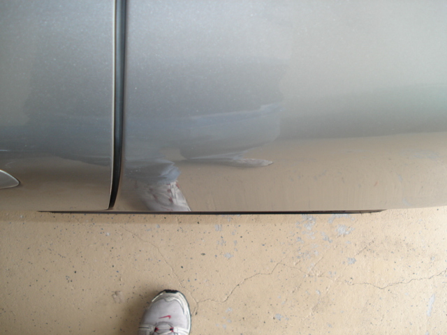

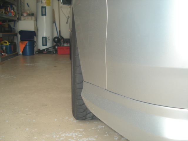

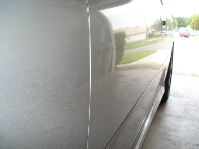

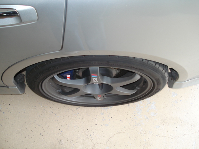

here are the pics, i figure these angles should work for you.
