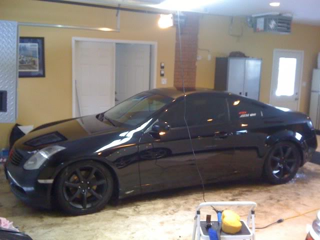

Heres a before and after of my car. excuse the quality. Iphone photos.
Before
After

You have stocks in the company or something?
Nice write-up.
I know a lot of people have been flaming you for it, but to each their own.

Calvin's Avatar
Overglorified Altima
iTrader: (65)
Posts: 53,506
Likes: 187
From: Chicago
Looks better stock. And this is not hating on plasti-dipping. I'd have said the same if you used regular paint.
Old Jan 23, 2011 | 07:38 PM
dumbg35x's Avatar
Joined: Oct 2008
Posts: 228
yea looks better stock unless you going for the black out look.

Looks pretty good u should do more coats then 2 tho.. And did u do your trunk as well?? Idk If it's just me but it looks flat black
