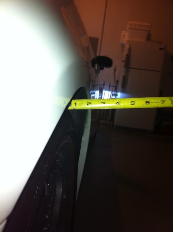

i recently picked up a set of 19" Iforged Aero, 19x8.5 and 19x11 but the previous owner don't know the offset of the wheels.
after putting the wheels on, it wasn't an aggressive offset. so i was thinking about getting spacers but im not sure what to get. I'm currently running 265/35/19 and 225/35/19
both front and rear wheels have about 1" space between the rim's lip and the fender's line.
i was thinking either 25mm all around, 30mm all around, or front 30mm and rear 25mm
please me know what you guys think. thanks
here's some
front:
rear:
the car:

i would take a 2x4 piece of wood or something similar, just long enough to lay flat on the rim and short enough to completely get it to touch the bottom of that fender. Maybe even a pizza box would work. This would get you a better measurement on what size spacers you're looking for. i can't find a good picture showing this, i might have to snap some pics later if you still need clarification.
By the looks of that offset gap, you're looking at a pretty huge spacer. At least 30mm, IMO.

actually here you go...
1in = 25.4mm

yeah it depends on what look you are goind for. I like a real flush look, which is what i think youre looking for right? id go 30mm in the back and 20 in the front. You look like you have a larger gap in the back. If you want buy the 20mm first, see how they look on the back and if you need more get 30mm and put the 20s on the front or if its good put the 20s on the back and then order 15mm for the front.

Thanks cantdiels. I'm actually planning to get an 25mm and test it but most likely I will do 25 front and 30 rear because the rear does seem to have more gap.
