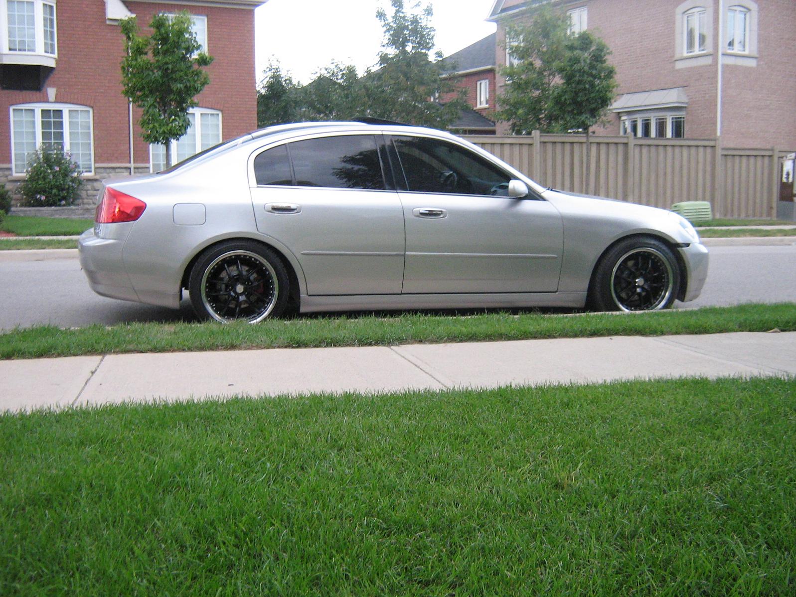

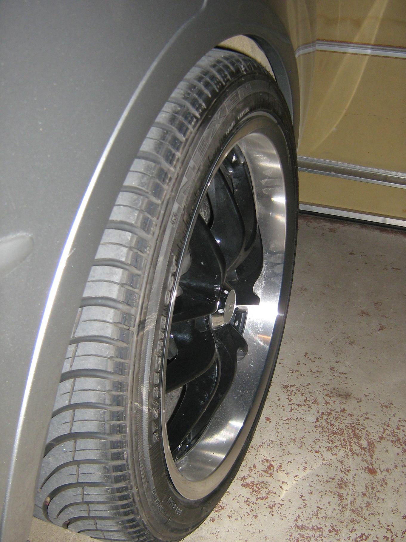

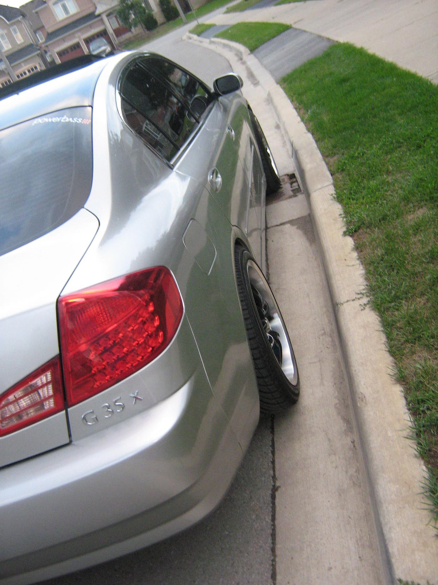

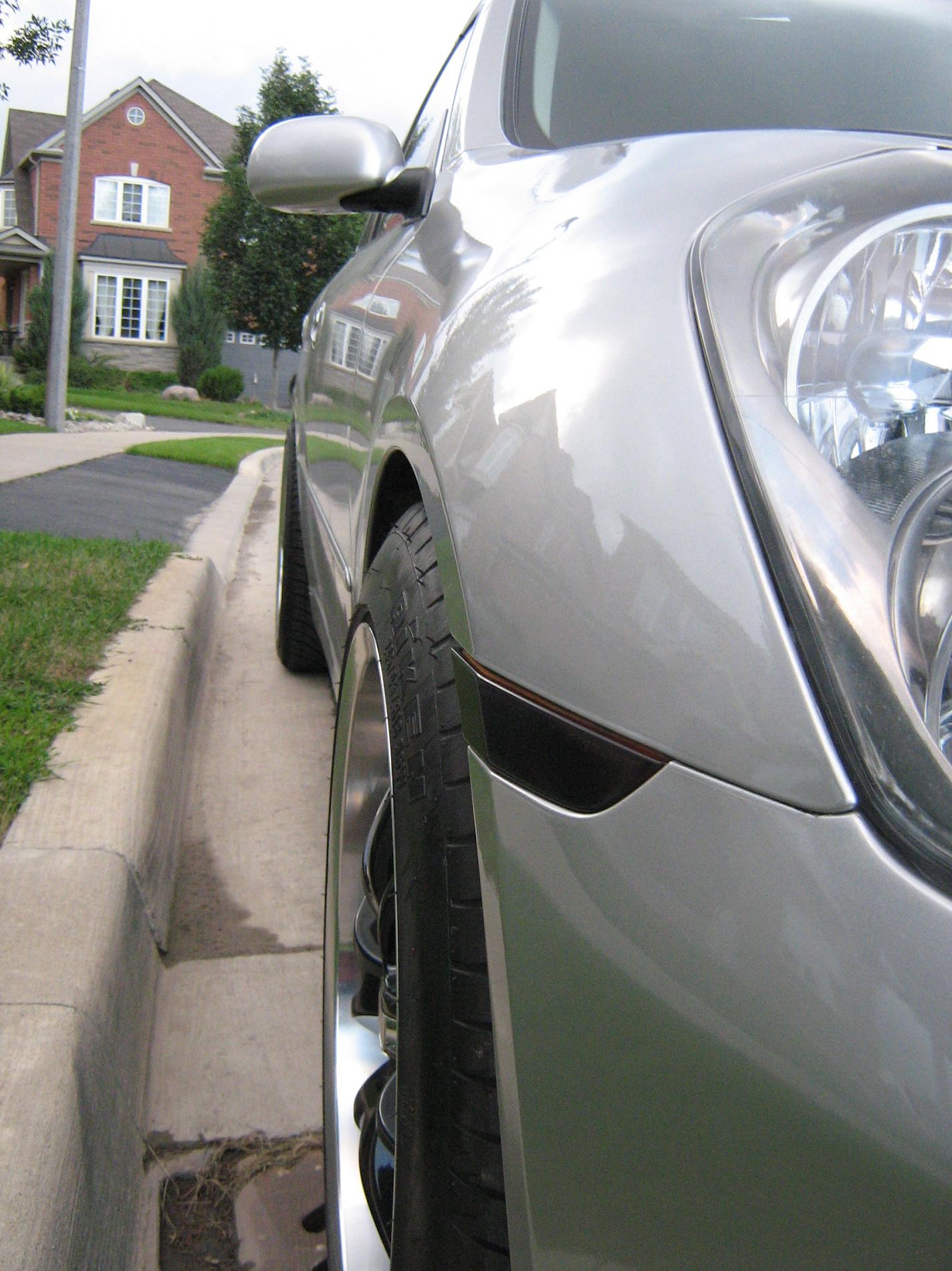

So i put new wheels on today and my first issue is that, whenever i go up bumps or anything i always hear the back tires, i feel like there getting hit but the wheel gap and i felt some tire coming off.
what should i do? should i roll the fenders or no?
i have it lowered on tein S tech springs with 18" IKON Massaru rims
Tire size front - 245/45/ZR18 96w
Tire size rear - 275/35/ZR18
so my question is what do i need to do to get a smooth ride? without hearing the tires rube or anything
i want to do something asap so i can drive it without being scared of messing up my tires

Find out how much it's rubbing then get your fenders rolled. What are the wheel specs?

You'll be OK ; but need the rear fender flanges to be rolled up to enjoy a quieter and safe ride.
The slight rear tire thread rub will never self adjust out of the burning contact of metal to rubber.
Have those 2 flanges done and the rub, zip noise and unsafe feeling is eliminated.
I can see in your pic that the outside thread is scraped. Feel up under the top of fender lip and you will find the rubber marbles on the flange.
