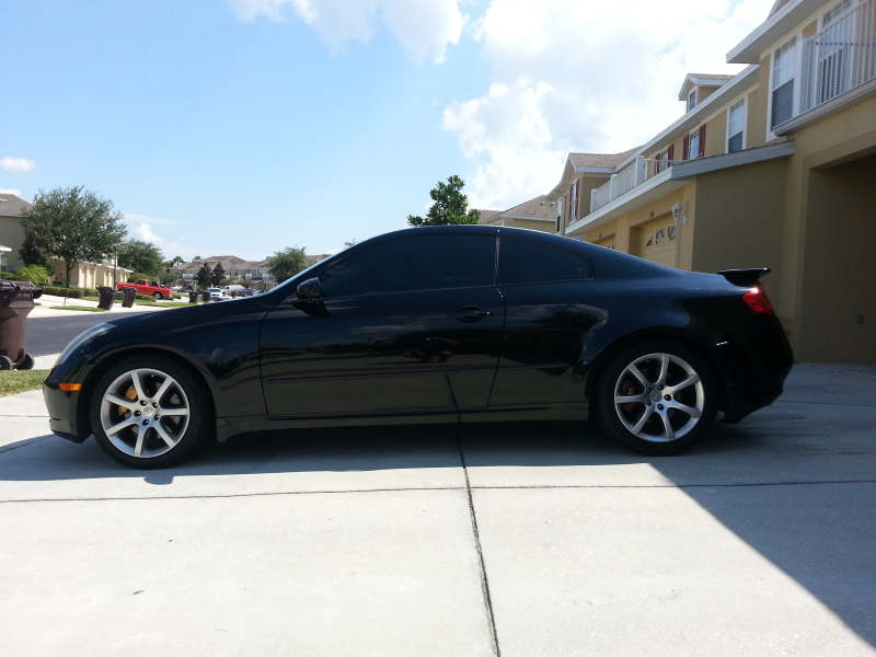

19x9.5 +12 10.5 +17......will it fit on my 04 g35 and will it look nasty?

Just FYI, there is a thread dedicated for questions like these. Post in there and you will get help. Those will fit, but it all depends on what size tires, camber, etc you plan to run/should run.

I will look nasty without a drop..

+12/+17 will be mildly aggressive now a days. It will fit. I recommend a drop first.

yeah i will do the drop with bc coilover but i just want to make sure it will fit and run ok since its my daily driver... and when you say mildly aggressive what do you mean by that

They will fit with a drop and rolled rear fenders, if you want camber in spec stretch the tire a little if you want to run full size tires then camber.

You'll fit easy. I had 10.5 rears on 285/35 tires and with a roll I didn't rub anything at all.
