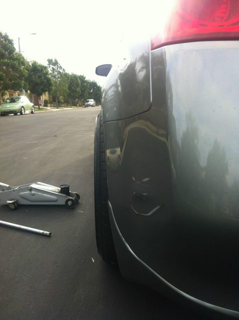

Hey guys, I test fitted the rear 255/35/19 and here are the results
The wheel gap is larger than I thought it'd be, maybe it's because I took the picture a minute after I lowered the jack so the springs haven't returned to normal yet? If not, then I guess I won't be needing to roll my fenders until I get a bigger drop. I'm not sure.
Also, what should I do about this? It really sticks out quite a bit. Should I leave it?
Thanks guys, I really appreciate it!

As i stated, you would need a lower drop to make it look good.

Now you need to drop it, it will fully tuck that...
